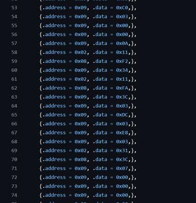

Dear Federica Bossi,
We are considering using the configuration file titled "LSM6DSOX Activity Recognition for Wrist" directly, instead of generating a new MLC user configuration file.
I have attached a screenshot of the configuration file. In this file, I noticed that multiple data values are written to the same register address, specifically 0x09. Could you please clarify the reason for this? What is the purpose of writing different values sequentially to the same address?
Additionally, when we load this configuration using the example code you previously shared, how does the system handle multiple entries for the same address? Does it write them in sequence, and if so, what effect does this have on the configuration or operation of the device?
Your guidance on this would be greatly appreciated.
