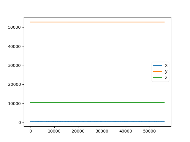

IIS2DPC getting Status=0x21 X=476, Y=52676, Z=10472 with no trigger to the sensor. On the slightest tap, the value shoots to 64K
VJaha.1
0693W00000D0q2zQAB.pngMy Senosr board is on the table with no vibration event applied to it. Instead of seeing a value of zero or something close to zero, I am reading the X, Y, Z values as ( X=476, Y=52676, Z=10472).
What is the issue here and how to fix it?

Hi, are you in high resolution (14 bit) or in Low power mode (12 bit)?
And also are you sure you are correctly concatenating the OUT_axis_L and OUT_axis_H data? Could you share the hex values?
Tom
VJaha.1
I am in Low Power mode `IIS2DLPC_CONT_LOW_PWR_LOW_NOISE_4`
The Values for the LA are as follows {x_l:28, x_h:29, y_l:2a, y_h:2b, z_l:2c, z_h:2d}:

x= 0x01dc =476
y= 0xcdc8 = 52680
z= 0x28e8 =10472
