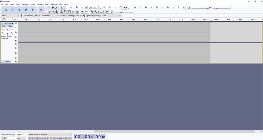

I can see the microphone in device manager (STM32 AUDIO Streaming in FS Mode)
But in Audacity when I record I get no input
What am I doing wrong?

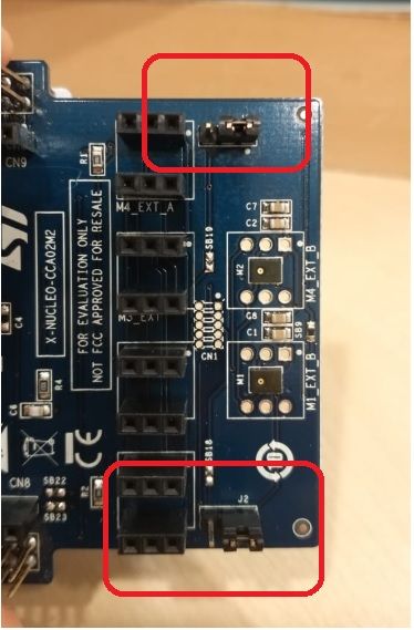

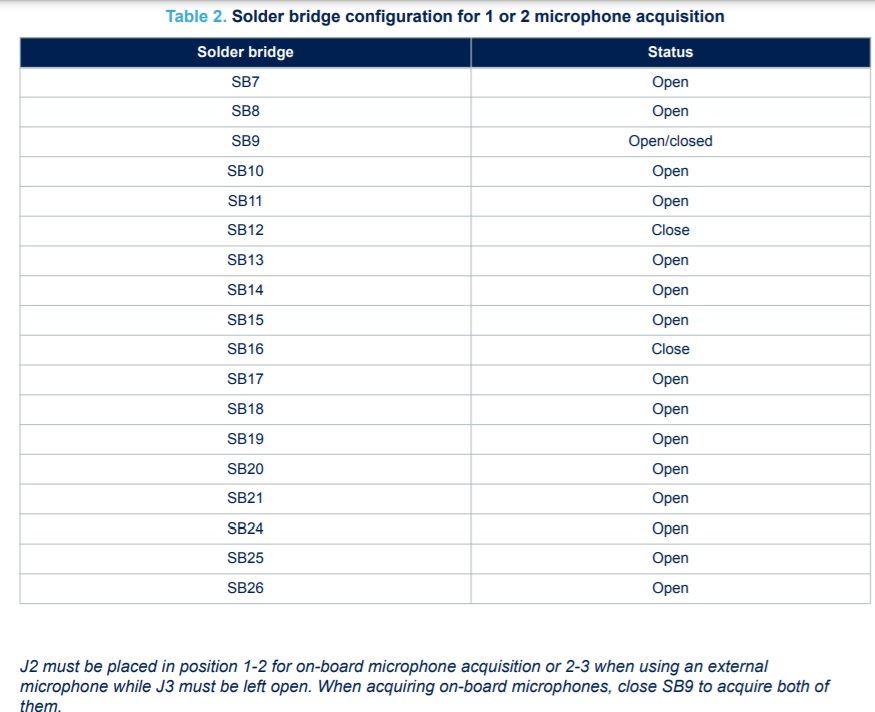

I had exactly the same problem as you. You will need to configure the SB part accordingly. Please refer to UM2631 (https://www.st.com/en/ecosystems/x-nucleo-cca02m2.html#documentation).
Also, make sure J2 & J3 have the correct configurations as below:

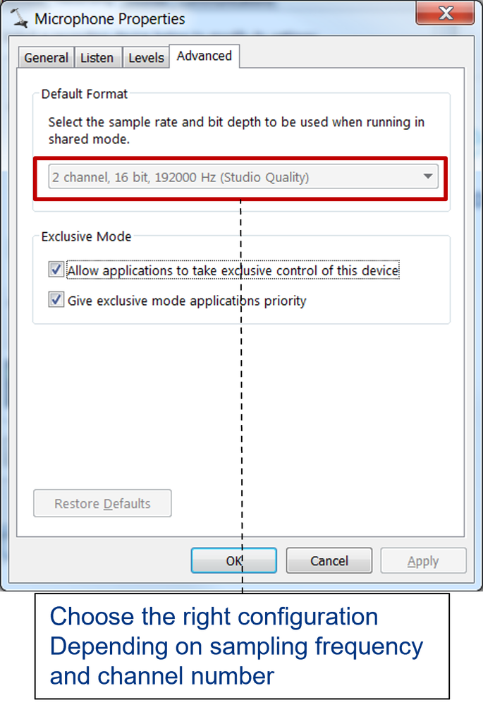

can you please check if the project rate, that I see you set (or is by default set) equal to 48kHz, is the same as the one as in the Microphone input windows configuration? (48kHz should be enough)
By the way, which operating system are you using?
-Eleon

The configuration is 48kHz, same as audacity project (and same as the bin file L476RG_CCA02M2_2ch_48KHz.bin)
I am using Windows operating system
STM should really highlight this in their Quick Start Guide.

DTobe.1
 @Khoo.B​ @Eleon BORLINI​
This worked!
Thank you very much
