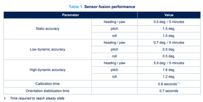

Finally, Table 1 of the datasheet specifies sensor fusion performance in three different scenarios: static accuracy, low dynamic accuracy, and high dynamic accuracy.
Do you have more details about what kind of conditions low dynamic and high dynamic accuracy represent please ?
