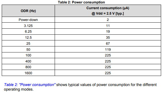

Hi all
Can I have a table of power consumption for LIS3DSH in different sampling rate?
Kind Regards
Reza
2 REPLIES 2
Eleon BORLINI
​Hi Reza, you can find the current consumption table in p.10 of the LIS3DSH app note AN3393
Regards
MNaee
Thank you Dear Eleon
It seems that power consumption of LIS3DSH is considerably higher that LIS3DH :)
