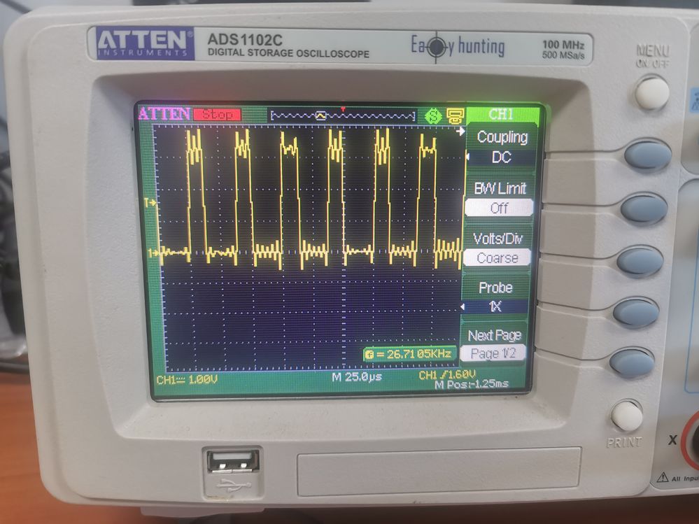

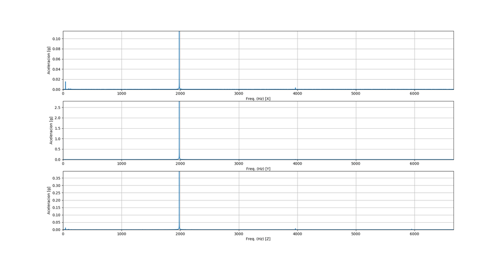

then we use the interrupt of the int1 pin to perform measurements, we discard samples according to the descriptions of odr/4, odr/10, etc. but when we perform the FFT of the signal obtained, we realized that for a 2kHz signal the sensor means 1984Hz which made us think that the sensor means a higher frequency than indicated in the datasheet
0693W00000HrgcQQAR.pngThat is why we carried out an oscilloscope measurement on the interrupt pin and it showed us that the frequency of said pin was 26710 Hz, the datasheet indicates 26667 Hz, is this frequency correct?

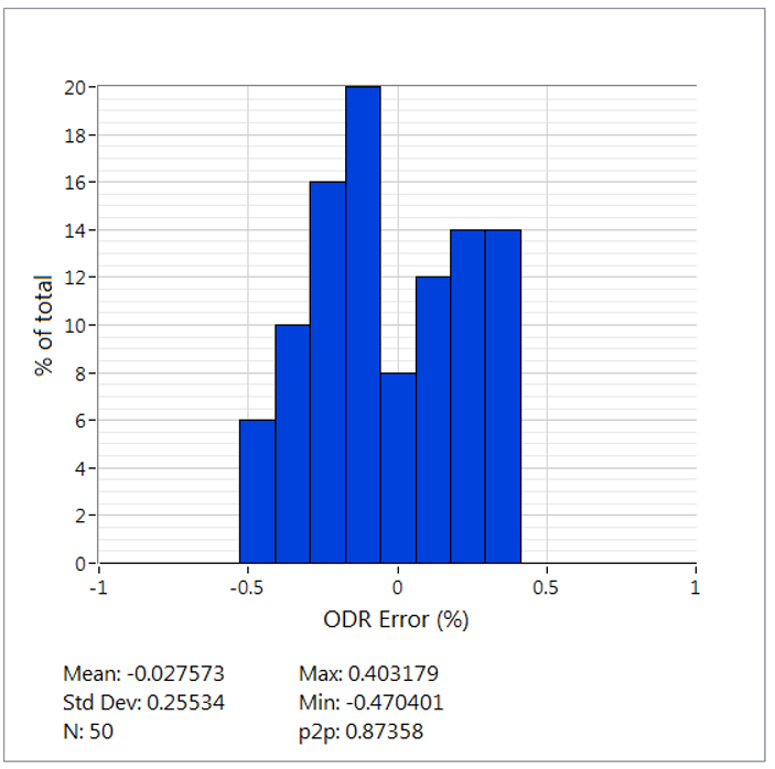

sorry for the delay in my answer, but yes, you are right: the output ODR can vary from the nominal value of 26.667kHz. And the correct way to detect its actual value is to measure the frequency of the DataReady interrupt.
I can share you some more details to justify this. The internal 5MHz clock have a non zero variability, that reflects on the ODR variation with respect to the nominal value, according the the below histogram:
