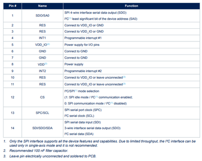

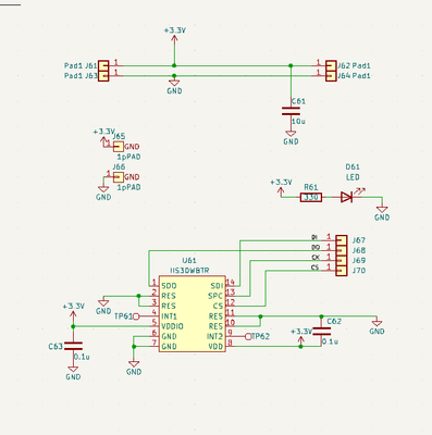

From the schematic I noticed that PIN 10 and PIN11 are connected to GND, but from our specifications, reported in the datasheet, they should be connected to VDD_IO or left unconnected. Try this and let me know if this solves.

Can you share more information about your setup? And also your schematic?

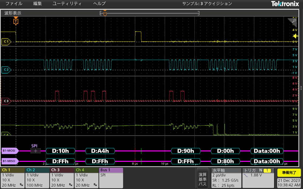

MCU R7FA6T2BD3CFP on HSBRA6T2F100, Hokuto electronics
SPI mode 3 / active high clock and
clock 10MHz
I also checked 400kHz, but it didn't solve the problem.
I will also share the command flow.
Read 0x0F and received 0x76 (01111011)
Write 0b0000 0100 to 0x10
Read 0x10 and received 0b0000 0000
Write 0b0000 0000 to 0x15
Write 0b1010 0100 to 0x10
Read 0x10 and receive 0b1000 0000
And I share my schematic of IIS2DWB test piece.
