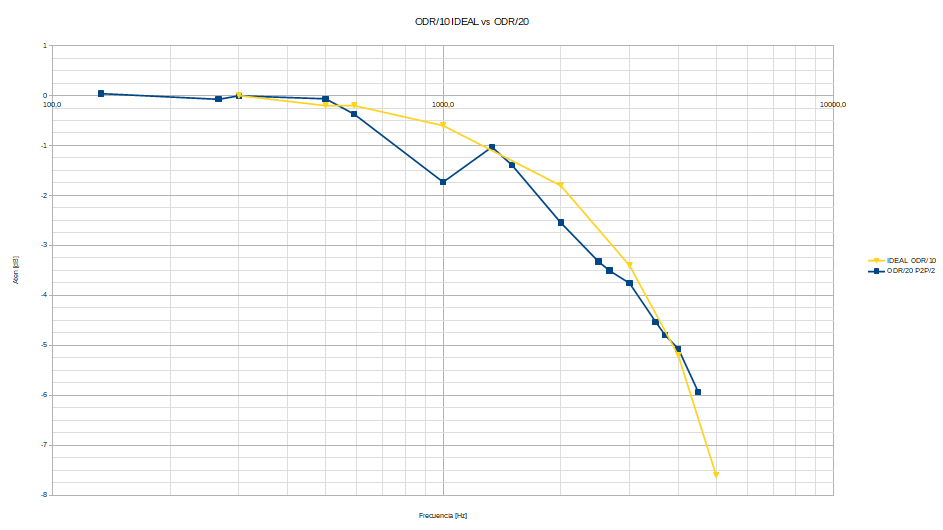

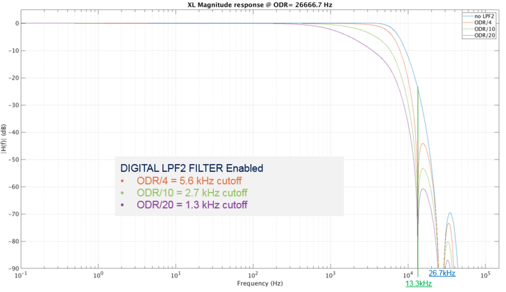

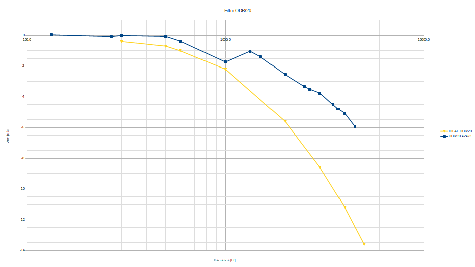

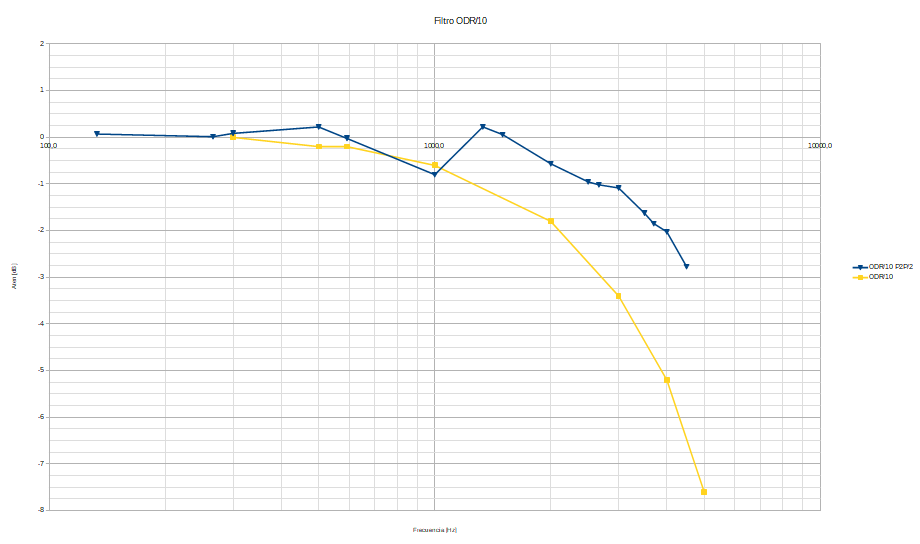

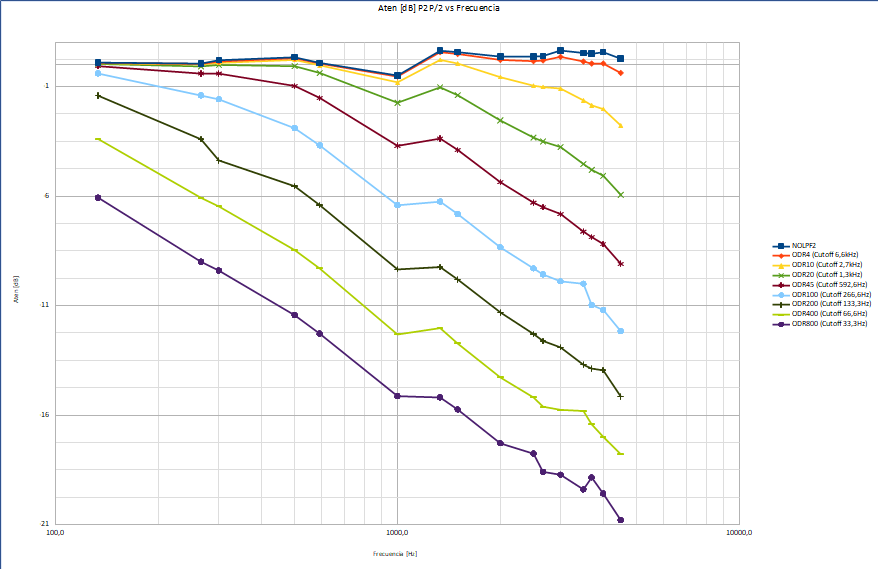

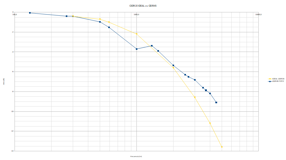

We have been using the IIS3DWBTR sensor for some time and have observed some odd behavior regarding filters. We recently performed some experimental tests on the LPF2 Filter to corroborate the frequency response curves on page 20 of the datasheet and found that it didn’t behave as intended. Oddly, we found that (experimental artifacts aside) the experimental curve had a better match with the *next* filter cutoff configuration. For example, the experimental results when configuring LPF2 with a cutoff frequency of ODR/20 has a good match with the theoretical curve for a cutoff of ODR/10, as shown in the next plots (yellow is theoretical, blue is experimental).
Theoretical response on page 20:

0693W00000KZwDDQA1.pngODR/10 Theoretical vs ODR/10 Configured:0693W00000KZwEaQAL.pngODR/10 Theoretical vs ODR/20 Configured:
0693W00000KZwFEQA1.pngODR/20 Theoretical vs ODR/20 Configured:
0693W00000KZwPYQA1.pngODR/20 Theoretical vs ODR/45 Configured:

The experimental tests were back-to-back tests against a reference piezoelectric accelerometer mounted on an electrodynamic shaker. The signal measured from the piezoelectric was used as reference to calculate the attenuation.
We would appreciate your comments regarding LPF2 performance from your experience or possible explanation for this behavior. Maybe we are not configuring it right. Any suggestion is welcome.

It is not clear to me which is the root cause of this "mismatch" between theoretical and experimental. I would suspect in the presence of a resonance peak around the -3dB roll-off point. Might it be caused by a true mechanical resonance due to spurious vibration of the setup? This peak seems to stay at a constant frequency, even when the frequency of the digital filter is changed. Are you using the STEVAL-MKI208V1K to run these measures?
