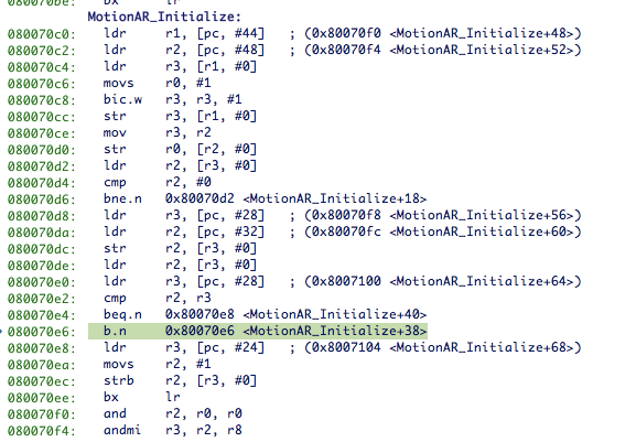

I am trying to add MotionAR library to a DataLogger sample application running on SensorTile. I manager to compile the library and program my chip with it. Near the top of my main() I added simple MotionAR_Initialize() and MotionAR_GetLibVersion() function calls. It seems that PC is getting stuck in a loop inside of the init function as shown below.
I can break out of this beq.n and b.n loop my moving the PC to the ldr line (080070e8) and the program continues fine. I am able to retrieve the version string from the GetLibVersion function.
Any idea what the init function is waiting for?

Please enable clock forthe CRC module in STM32 microcontroller, it is needed for Initialize function.

Ahhh, lovely. My pain and suffering solved in one line of code. Thank you!
__CRC_CLK_ENABLE();

Thank you very much ! I had exactly the same problem with execution stuck in MotionEC_Initialize or in MotionMC_Initialize and this solved my problem :grinning_face:
