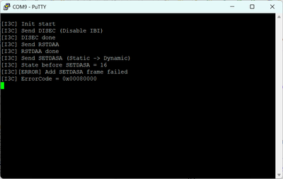

Hello!
I'm working on an Nucleo-H503RB board and trying to communicate with a LSM6DSO over I3C.
I am now able to use ENTDAA to assign a dynamic address to the LSM6DSO.
Next, I want to test using SETDASA to assign a dynamic address based on the static address (0x6A) of the LSM6DSO. I followed Getting started with I3C - stm32mcu(4.2 Dynamic addressing using SETDASA CCC section ), but encountered the following issue.
Issue:
The process stops at RSTDAA and does not continue to SETDASA.
I have already verified via I2C that the static address is 0x6A.
Question:
How can I successfully complete the SETDASA procedure?

Hello Foued,
I changed the dynamic address as below, but the logic analyzer shows the same result.
uint8_t aSETDASA_LSM6DSO_data[1]   = {(LSM6DSO_DYNAMIC_ADDR)};
I tried to print the procedure on the PuTTY log. It seems like it's stuck in adding the SETDASA frame.
  if (HAL_I3C_AddDescToFrame(&hi3c1,
                             aSET_DASA_LSM6DSO,
                             NULL,
                             &aContextBuffers[I3C_IDX_FRAME_1],
                             1,
                             I3C_DIRECT_WITHOUT_DEFBYTE_RESTART) != HAL_OK)
    printf("[I3C][ERROR] Add SETDASA frame failed\r\n");
    printf("[I3C] ErrorCode = 0x%08lX\r\n", hi3c1.ErrorCode);
    Error_Handler();
If I have taken any wrong step, please kindly tell me.
Thanks for help!

I resolved the issue by changing the RESTART in the Add RST frame to STOP.
    /*Add context buffer Set CCC frame in Frame context */
                               aSET_CCC_RST,
                               NULL,
                               aContextBuffers,
                               1,
                               I3C_BROADCAST_WITHOUT_DEFBYTE_STOP) != HAL_OK)
Thank you for your help!
