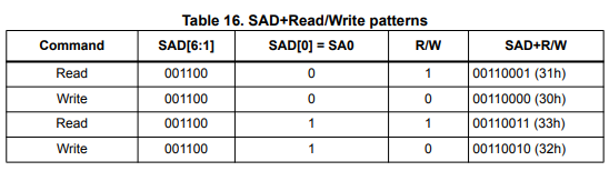

Sensor: LIS3DH. If I wire the SDO/SA0 to VDD, as pointed in the attached picture, will it cause any problems while using i2c? I currently can't READ and I am trying to identify the problem. Thanks,

Hi @DJi.1​ , the SDO/SA0 pin is internally pulled up, so no problem if you pull it up from outside. It is only used to define the slave address as described in the picture below, p.25 of the datasheet:
So if you keep it fixed to Vdd, you will be able to use only the b0011001 slave address (33h and 32h depending on the R/W case).
Regards

Got it. Thanks a lot!
