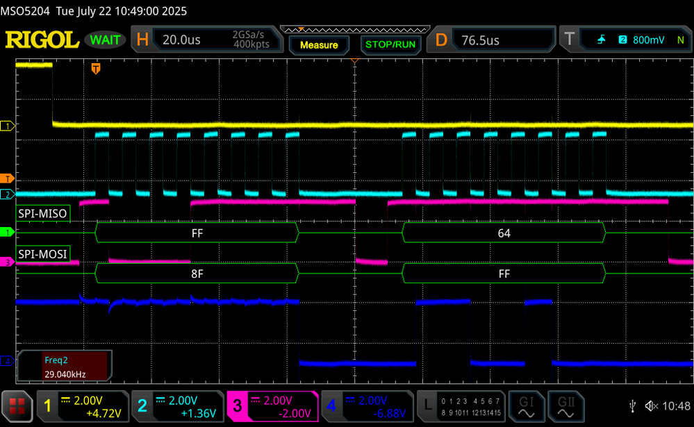

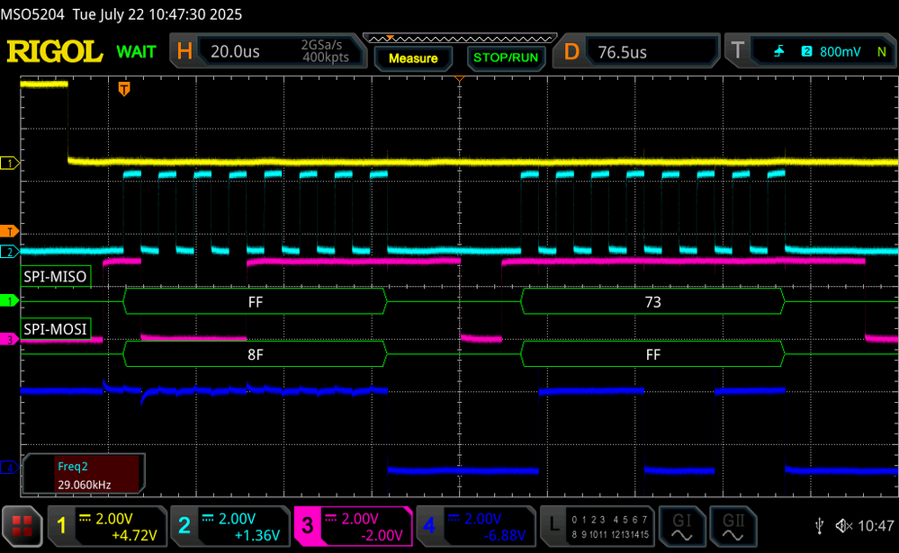

We're looking to use the lsm6dsv320x in our product. I'm using this senser on the on the STEVAL-MKI247A adapter board for testing. We're currently in development using the adapter board with the Nordic nRF52840DK board. I'm having issues with getting the correct value from the WHO_AM_I with certain SPI pin configurations on the nRF52840DK. I can only get one SPI configuration to output the correct value of 0x73 which is SPI1. If I try change the pins or use one of the other SPI's available on the 52840, I consistently get a value of 0x64. Does that value mean anything to anyone? I've tried lowering the frequency to 500kHz, tried all four of SPI modes, I've tried performing a reset using the FUNC_CFG_ACCESS and CTRL3 registers before reading the WHO_AM_I register, but I still get the value of 0x64 except with the one configuration mentioned. I'm using the ST fsm_example for this test. We would like to change the SPI pins as the we want to use the smaller package of the nRF52840 which doesn't have some of the default pins for this SPI! bus. I've looked at the waveforms on an analyzer and there seems to be plenty of setup and hold with the address and data. Any significance to the value of 0x64?Screenshot 2025-07-03 114225.png

single_wire_zoomed.png:
double_wire_zoomed.png:
What's the significance of "single wire" and "double wire" ?
Yep sorry, single wire is a single jump wire between the dk and the steval. double wire is a double jump wire connected in series between dk and steval to have a longer connection. The difference is only on the SDO/MISO line.
I want to show you a new screenshot. This time I removed the "clock stretching" changing how I call spi_transceive in zephyr os (it was tx 1 byte and rx 2 bytes now it is both 2 bytes, I don't know why in the previous configuration there was a clock stretching). I removed the pull up on the mcu side.

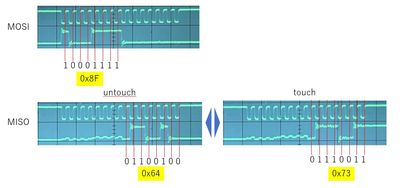

Interesting finding:
While testing with external pull-up/pull-down resistors on the SPI lines to see if it would affect the communication, I noticed something unusual:
When I physically touch the SCK line (even through the resistor lead), the WHO_AM_I register occasionally returns the correct value 0x73 instead of 0x64. This behavior is inconsistent and seems to depend on skin moisture/capacitance.
  • External resistors (1kΩ - 10kΩ) alone have NO effect
  • Only human touch changes the behavior
  • The effect is not always reproducible
This suggests the issue might be related to:
  • Signal integrity / impedance matching on SCK
  • Rise/fall time requirements
  • Capacitive loading effects
    I have recorded a video showing the oscilloscope waveform changes and WHO_AM_I value changes when touching/not touching the SCK line with the breadboard setup. (attached)
    Has anyone else observed similar behavior? Could this indicate a PCB design issue with the STEVAL-MKI251A board, or perhaps specific signal conditioning requirements for the LSM6DSV320X SPI interface?
    Any insights would be appreciated.
    Thank you,
That is so weird. Thanks for posting the video.

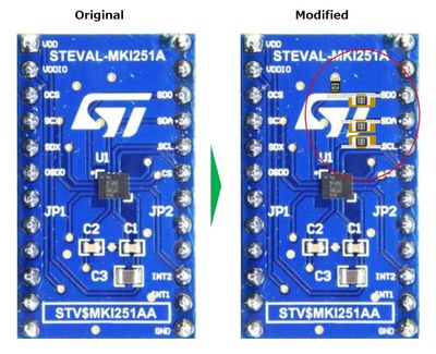

Following up on my previous report about the SPI communication instability (the "touching SCK changes behavior" phenomenon):
Solution Found:
Adding series termination resistors resolved the issue.
Hardware modification:
100Ω series resistors on SCK, MOSI, MISO lines (between sensor and MCU)
10kΩ pull-down resistor on MISO line (sensor side, close to chip)
Test Environment:
Sensor: LSM6DSV320X (STEVAL-MKI251A evaluation board)
MCU: ESP32-S3 (Seeed XIAO ESP32S3)
Interface: SPI, Mode 1
Connection: ~50mm jumper wires between sensor and MCU
Results:
WHO_AM_I register reads correctly and consistently (0x73)
All registers read/write stable, including sensor data burst read
No more intermittent communication errors
Important Finding:
I had similar SPI communication issues with ISM330DHCX (another ST MEMS sensor) in a previous project. At that time, I gave up on it and used another company's chip. However, when I applied the same series termination solution to ISM330DHCX, it also resolved that issue. This suggests similar signal integrity requirements may exist across ST's MEMS sensor family.
Note on Component Values:
The 100Ω value worked for my specific setup (ESP32-S3, 50mm wires, direct connection). Optimal values may vary depending on:
MCU type and SPI driver characteristics
Wire length and PCB layout
Sensor board design
I don't have equipment to measure precise impedance matching or signal reflection, so these values should be considered a working example rather than universal recommendations.
Implementation:
Since I couldn't place components between MCU and sensor board in my final design, I modified the STEVAL-MKI251A evaluation board by soldering chip resistors directly on it (see attached pictures).
If you have space outside of the board, you can also try using axial resistors or similar components.
Since the evaluation board doesn't have resistor footprints for series termination, I had to solder chip resistors directly. Would be nice to have those pads in future revisions!
