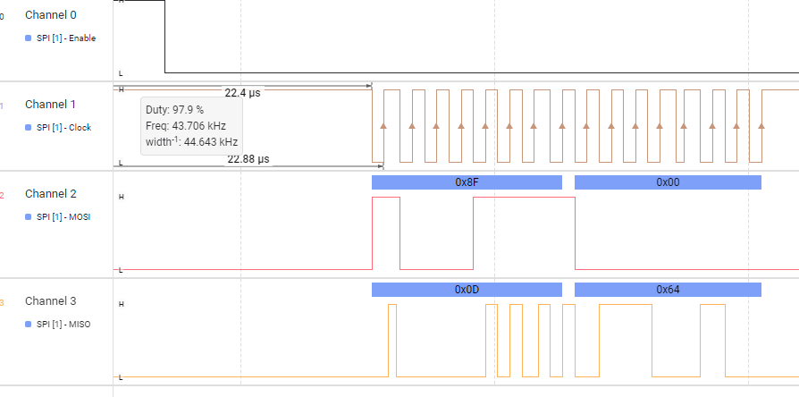

We're looking to use the lsm6dsv320x in our product. I'm using this senser on the on the STEVAL-MKI247A adapter board for testing. We're currently in development using the adapter board with the Nordic nRF52840DK board. I'm having issues with getting the correct value from the WHO_AM_I with certain SPI pin configurations on the nRF52840DK. I can only get one SPI configuration to output the correct value of 0x73 which is SPI1. If I try change the pins or use one of the other SPI's available on the 52840, I consistently get a value of 0x64. Does that value mean anything to anyone? I've tried lowering the frequency to 500kHz, tried all four of SPI modes, I've tried performing a reset using the FUNC_CFG_ACCESS and CTRL3 registers before reading the WHO_AM_I register, but I still get the value of 0x64 except with the one configuration mentioned. I'm using the ST fsm_example for this test. We would like to change the SPI pins as the we want to use the smaller package of the nRF52840 which doesn't have some of the default pins for this SPI! bus. I've looked at the waveforms on an analyzer and there seems to be plenty of setup and hold with the address and data. Any significance to the value of 0x64?Screenshot 2025-07-03 114225.png

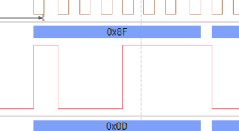

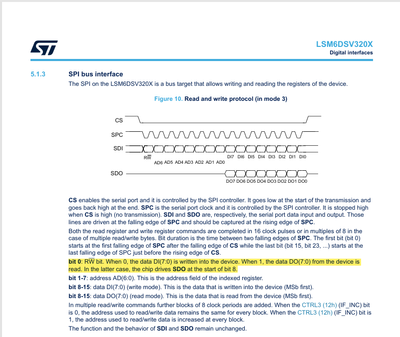

You're reading register address 0x8F. The WHO_AM_I register is register address 0x0F.
https://www.st.com/resource/en/application_note/an6119-lsm6dsv320x-6axis-imu-with-ai-highg-accelerometer-and-embedded-sensor-fusion-for-highend-applications-car-crash-detection-stmicroelectronics.pdf
Does it show any difference between "working" and "non-working" cases?

The difference between the waveforms is that it accurately shows the data value that is being received by the 52840. 0x64 which is the incorrect value and 0x73 which is the correct value. So, the waveforms are accurately showing the incorrect/correct data being produced by the lsm6dsv320x.

I have the same board (steval mkI247AA) and I noticed the same exact issue.
I am using a nrf2340 dk as main board and the steval is on a breadboard and I connected the dk with the breadboard using jump wires.
I transmit 0x8f and I receive 0x64 on the second received byte. If I make a longer connection SDO -> MISO (i.e. double jumper wire), I read 0x73! And the waveform is completely different looking at the oscilloscope, it's a clear 0x64 and a clear 0x73. It's like the chip is changing is output.

the waveform is completely different looking at the oscilloscope, .
Please post oscilloscope traces of both cases.
(If at all possible, Please use the scope's screen capture, rather than photographing the screen)
thanks for your reply. I attached two screenshots with the two cases, I am still with two jumper wires. I'll try with soldered connections. Yellow CS, cyan CLK, violet MOSI and blue MISO.
