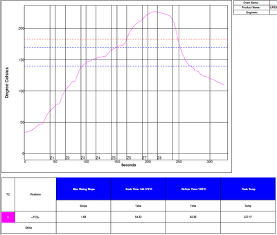

Hi @tve ,
This solution is not suggested because we have never tested this case and we don't know the reaction with the gel.
We can provide the temperature profile used by our subcontract, here attached. That is compared with standard JEDEC profile:
Hope this helps.
