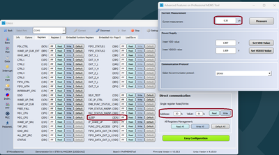

I'm evaluating the LIS2DUX12 accelerometer by using the combination of STEVAL-MKI109V3 and STEVAL-MKI238A. In the datasheet it stablishes that it can reach down to 10 nA during deep power-down:
But when I measure the current consumption through Unico-GUI, it says it consumes 2 uA which is similar to the consumption described as "ultralow-power mode" in the datasheet.
I would like to know if I'm missing something to modify in order to achieve the datasheet value or is it just that STEVAL-MKI109V3 is not capable to measure such low current.

Federica Bossi
Hi @sch0bert ,
It is a known bug in the fw of the STEVAL-MKI109V3, it was already fixed in the new fw version that is internally available:
I will update you as soon as this version will be available online. Thanks for your patience!

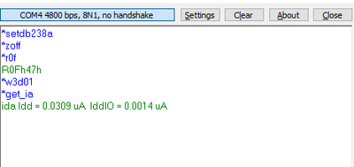

Hello @Federica Bossi
Thanks for you reply, I applied the value to the 0x3D register as specified in the datasheet and pointed by you and I see an improvement in the power consumption but still 30 times above the expected value:
Regards,
Pascal.

Thanks for the heads up @Federica Bossi! So is it in theory being reduced down to ~2 nA when I set the 0x3D register and just not being reported correctly by the STEVAL-MKI109V3?
Exactly, it is a problem of Unico fw but with the new release you will see a current consumption in deep powerdown of about 20nA.
