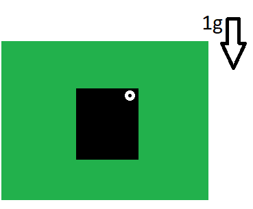

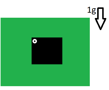

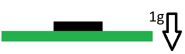

The accelerometer is horizontal, in the Z axis 1g and I have about 500 mg in the X axis. I have 3 pieces of accelerometers and in similar positions I have different readings from the X axis.

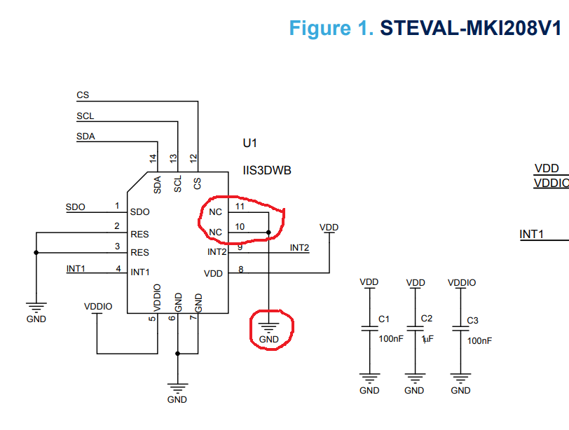

I found a certain inaccuracy:
in the documentation:
in the evaluation board:
could this be the cause of the error? I also have an evaluation board and it works ok.

your finding (the fact that the datasheet and the adapter schematic are showing different configurations for those pins) is correct, but there is no difference/effect of this on the data-out of the IIS3DWB devices.
I have some questions to try a better understanding of the issue: how many samples do you have tested? And are all these samples doing the same thing? Did you test all the samples soldered on the adapter? And is this "just" an offset of 500mg or is a high noise (for example a data that is jumping from 0mg to 500mg in a steady state condition, i.e. with the z axis pointing upwards and, possibly, with no tilts along x and y axis)?

It is not noise, it is a fixed value. In the above case on the X axis it varies between 410-450mg.
if I turned on the high-pass filter, the measurements for all axes are within 30mg max.
