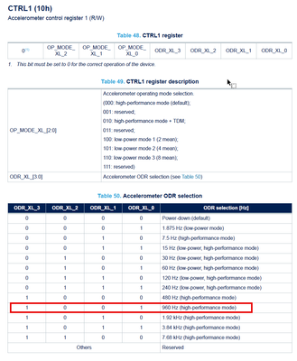

±2g is set.
I haven't done anything yet
except set CTRL1(10h) to 960Hz and read with 10mSec (100Hz) with the I2C bus (1MHz).
I have enough power available but reading faster than 100Hz is not so easy.
Should I choose low-power mode3 (8mean)? Or a high performance mode?
Should I enable the BDU bit anyway?

Hi @Stefan3 ,
Yes, it is always suggested to enable the BDU bit.
In addition, high performance mode is suggested for this kind of application :)
