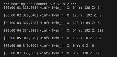

im having some issues with lis3dh data.

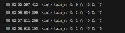

So im trying to configure and read data from sensor, but its invalid. When i read my buffer L values that are 0 2 4 they seem right:
But when i try to connect the data or even read 1 3 5 value that are H, its starting sending some values that are 100% incorrect. Im not moving sensor in any direction.
These are H value. When i connect them.
x = buffer[0];
x |= ((uint16_t)buffer[1]) << 8;
y = buffer[2];
y |= ((uint16_t)buffer[3]) << 8;
z = buffer[4];
z |= ((uint16_t)buffer[5]) << 8;
doing sth like this the values jump from 32k/16k and 0.
I have no idea what's going on. Im just sending adress to X_L with setting 1 MSB for auto increment.
Ofc, ive configured sensor CTRL_REG to turn on normal mode 100Hz XYZ axis ON and 2g.
