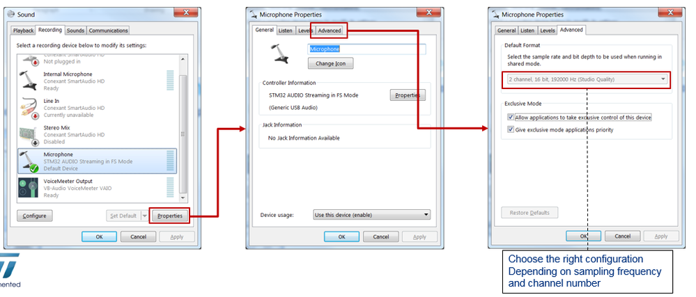

Hi, if you are using win7, the device is recognized as a standard, xx channels microphone. If you did't already do it, you should check the mic configuration, right clicking on the loudspeaker icon on the bottom right of the windows screen and choose “Recording devices�? in the following way. Regards

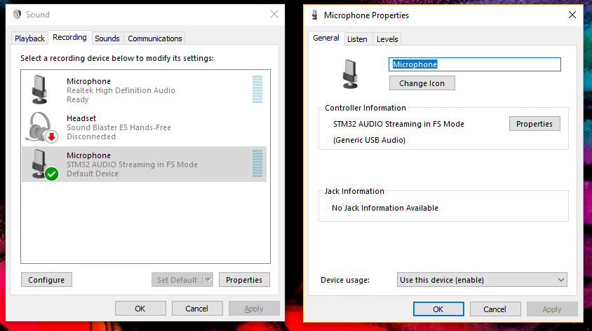

I am using Win 10,
that is what I see when the configuration is 2 channels, 48000 sample rate.
the Advanced Tab not exist.

I have similar problem with Nucleo-L476RG and MEMSMIC1 5.4.0 package. In 48KHz, the Advanced tab is gone and Audacity or other recorders failed to start recording. Also on Win 10. Any solution now?
Update: The only sampling rate that works on my machine is 192KHz. Then I remember I run the X-NUCLEO-AMICAM1 demo project at first, which is 192KHz... then I modify it to 48KHz or others and not working.
I guess windows don't like sampling rate change on the SAME device. I'll try change some USB device descriptions, see if it will be recognized as a new device with 48KHz.

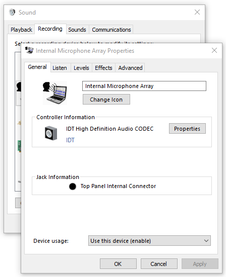

that's strange... I can see the configuration with Win10... may it be a matter of administration permissions?
You may try this other way. Go to Sound settings --> Input --> chose the correct input microphone --> Device properties --> Additional device properties --> Advanced
-Eleon
That is exactly what we do. The problem is: the Advanced tab is not there, if we set other sampling rates (except 192KHz in my situation) in the project and build and run.
Aren't you able to see the "Advanced" tab in any case? I mean, don't you see it also when selecting the "Internal microphone"?
