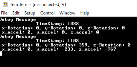

I am using MotionDI library with sensortile (STEVAL-STLKT01V1).I modified the existing 'DataLog' application to include MotionDI_update function. But the MotionDI_update function halts after giving the rotation and acceleration once. How to resolve this?

I want continuous output that indicates the tilt orientation and linear acceleration of the device. Any help or guidance regarding the query will be appreciated.

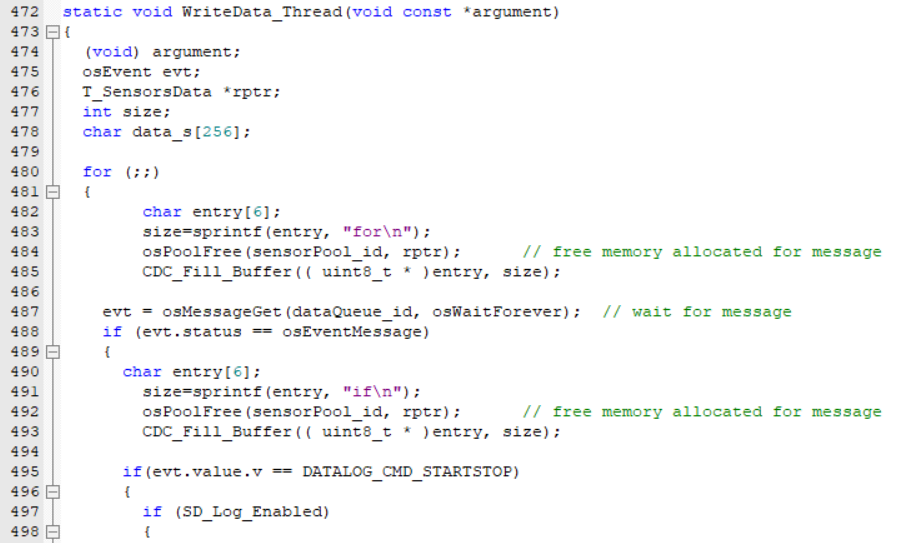

Miroslav BATEK
Would please try to increase the stack size?
QAbba.1
Hi @Miroslav BATEK​ ,
Thanks for the reply. I will try this and get back to you.
Meanwhile, I want to tell you that my initial debugging suggests that the issue is in line # 487 of the code image attached to this message. The message does not seem to arrive within the timeout limit. What is going wrong?

/* MotionDI_update function is called within WriteData_thread function */
static void WriteData_Thread(void const *argument)
  (void) argument;
  osEvent evt;
  T_SensorsData *rptr;
  int size;
  char data_s[256];
  for (;;)
		char entry[6];
				size=sprintf(entry, "for\n");
				osPoolFree(sensorPool_id, rptr);      // free memory allocated for message
				CDC_Fill_Buffer(( uint8_t * )entry, size);
    evt = osMessageGet(dataQueue_id, osWaitForever);  // wait for message
