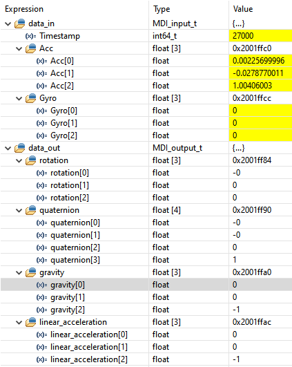

I'm trying to use the MotionDI library for a dynamic inclinometer application. My IMU is the LSM9DS1. The returned data from MotionDI_update() is shown below:
0693W00000Bczh6QAB.pngThe values for rotation, quaternion, gravity, and linear acceleration never change, even when the IMU is moved. I initialized the MotionDI library according to the sample code in the documentation:
float freq = 100.0f;
MDI_knobs_t iKnobs;
MDI_knobs_t *ipKnobs = &iKnobs;
int main(void)
  HAL_Init();
  SystemClock_Config();
  MX_GPIO_Init();
  MX_USART2_UART_Init();
  MX_I2C1_Init();
  MX_CRC_Init();
  MX_NVIC_Init();
  MotionDI_Initialize(&freq);
  MotionDI_setKnobs(ipKnobs);
  while (1)
      lsm9ds1_read_data_polling();

OK, the data are OK. I'm able to get correct output values from MotionDI library using your data.
I checked you code and I see you call MotionDI_setKnobs(ipKnobs); function without settings the knobs parameters.
You can check application example in X_CUBE-MEMS1 package.
You should read the default knobs settings and the modify the only settings you need.
 MotionDI_getKnobs(ipKnobs);
 ipKnobs->AccKnob.CalType = MDI_CAL_CONTINUOUS;
 ipKnobs->GyrKnob.CalType = MDI_CAL_CONTINUOUS;
 BSP_SENSOR_ACC_GetOrientation(ipKnobs->AccOrientation);
 BSP_SENSOR_GYR_GetOrientation(ipKnobs->GyroOrientation);
 ipKnobs->SFKnob.output_type = MDI_ENGINE_OUTPUT_ENU;
 ipKnobs->SFKnob.modx = DECIMATION;

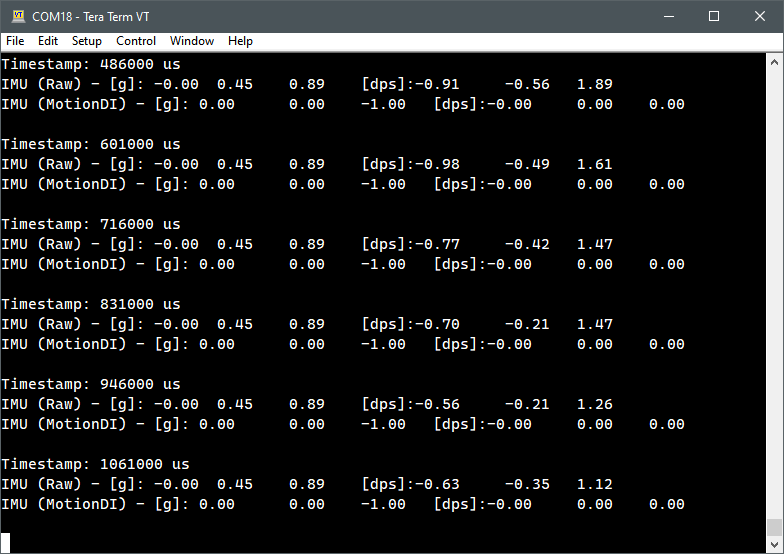

By datalog do you mean the output on the serial monitor? If so here it is, with the IMU tilted 45 degrees:

Miroslav BATEK
Thank you for the datalog, the data from accelerometer and gyroscope looks good, but your update data rate is low. I see the update data period is about 115ms.
Can you please update your code to increase the speed so the period is ideally 10ms.
I increased the speed to 10ms but the output still hasn't changed. I've attached another datalog, this time with the outputs in addition to the inputs. Each row is data_in.Timestamp, data_in.Acc[0], data_in.Acc[1], data_in.Acc[2], data_in.Gyro[0], data_in.Gyro[1], data_in.Gyro[2], data_out.linear_acceleration[0], data_out.linear_acceleration[1], data_out.linear_acceleration[2], data_out.rotation[0], data_out.rotation[1], data_out.rotation[2].
After setting the knobs parameters, the MotionDI library works. Thank you!
