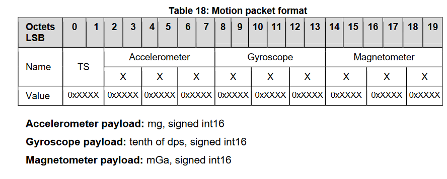

We are connecting the "00E00000-0001-11E1-AC36-0002A5D5C51B" characteristic which is an aggregate of the movement sensors. It follows this form:
X = read(chr)';
% where:
X' =     [73     4   246   255   156     3   182     1   214   255   136     1    18   254    30     0   201   254   194     1]
(3) As you can see in the figure above, we need to access Bytes 2-7 for the accelerometer, and convert from the native unsigned 8-bit integers ("unit8") that MATLAB reads in, to signed 16-bit integers ("int16"):
XYZ = double(typecast(uint8(X(3:8)),'int16'));

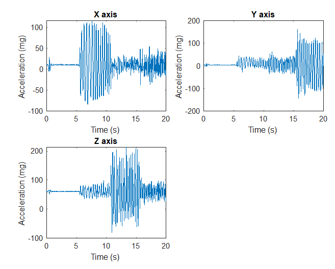

(4) Finally, convert to engineering units, following the formula helpfully sourced in the comment by Eleon, above:
XYZ = (XYZ.*61)/1000;
You can see the output below:
0693W00000FBPJFQA5.pngGood luck!

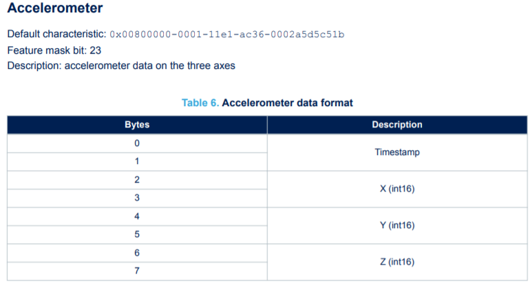

(A) The characteristics looks correct, you could try to require only the 3 axis data using the following string --> 00800000-0001-11E1-AC36-0002A5D5C51B
0693W00000Dm0SXQAZ.png(B) The accelerometer (IMU) mounted on the STEVAL-WESU is the LSM6DS3, so you can refer, for example, to the C drivers on Github for an easy conversion formula from the LSB units to the physical ones (see lsm6ds3_reg.c)

However, table 6 you sent above makes me expect a vector of 7x1.
his is where I am stuck - how do I convert this into the correct format. I figure this list is a set of 8 bit integers that I should convert to 16 bit integers, using MATLABs typecast function which converts from uint8 to uint16 by parsing the vector in pairs:
        ACC= double(typecast(uint8(X(bInts)),'uint16'));
This however isn't yielding any sensible output that conforms to movement - I figure I am reading something in the wrong order?
