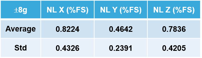

2021-03-23 7:17 AM
You answered my questions concerning axis misalignment, thanks a lot !
Regarding the bias stability, can you tell me the observation time (period) ?
Regarding the scale factor, I'm interested in the accuracy of the scale factor (not of the scale factor value itself). Do you have typical values of the accuracy (precision) of the scale factor for gyroscope and accelerometer (in ppm or %) for FS=+-8g and for FS=+-2g?
Thanks again, you are very helpful.

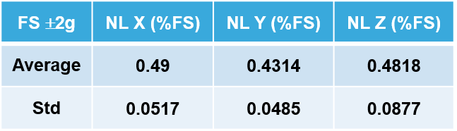

2021-03-23 9:39 AM
Hi @NPoth.1 ,
you are welcome.
For the bias stability, the observation period is 72h.
For the accuracy/precision parameter, I can share you the sensitivity error in non linearity:
-Eleon

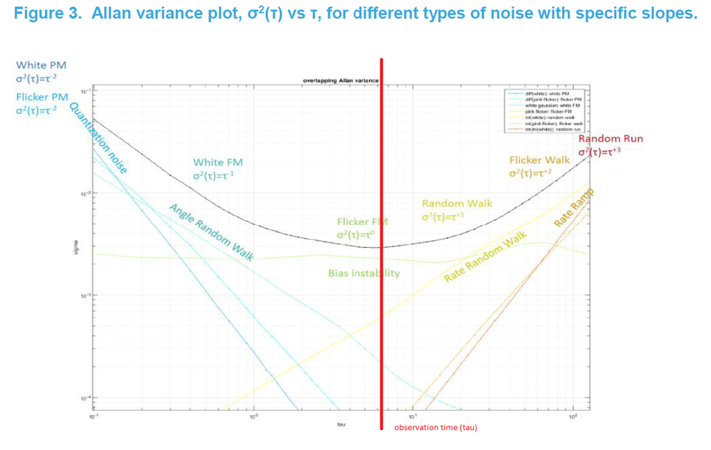

2021-03-24 5:08 AM
For the bias stability, I expected an "observation time" in second. For me, the "observation time", is the value on the x-axis (tau) where the Allan variance is smaller.
For the accuracy/precision parameter of accelerometer, thanks, you answer my question.
What about the accuracy/precision parameter of gyroscope ?

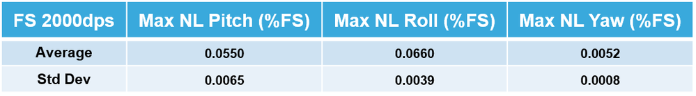

2021-03-24 7:24 AM
Hi @NPoth.1 ,
ok, I was thinking to the whole acquisition time. Yes, the tau unit measure (average time) is seconds.
>> What about the accuracy/precision parameter of gyroscope?
For the gyroscope I can share you the NL in the +-2000 dps case:
Other questions? :grinning_face_with_sweat: ;)
-Eleon
2021-03-24 7:34 AM
:grinning_face_with_sweat: :smiling_face_with_smiling_eyes:
So can you tell me the tau value for bias stability of accelerometer and gyroscope ?
Thanks for all !
2021-03-25 4:11 AM
Hi @NPoth.1 ,
the cluster time for both accelerometer and gyroscope in the bias stability region of the AVAR plot is about 20s.
-Eleon
