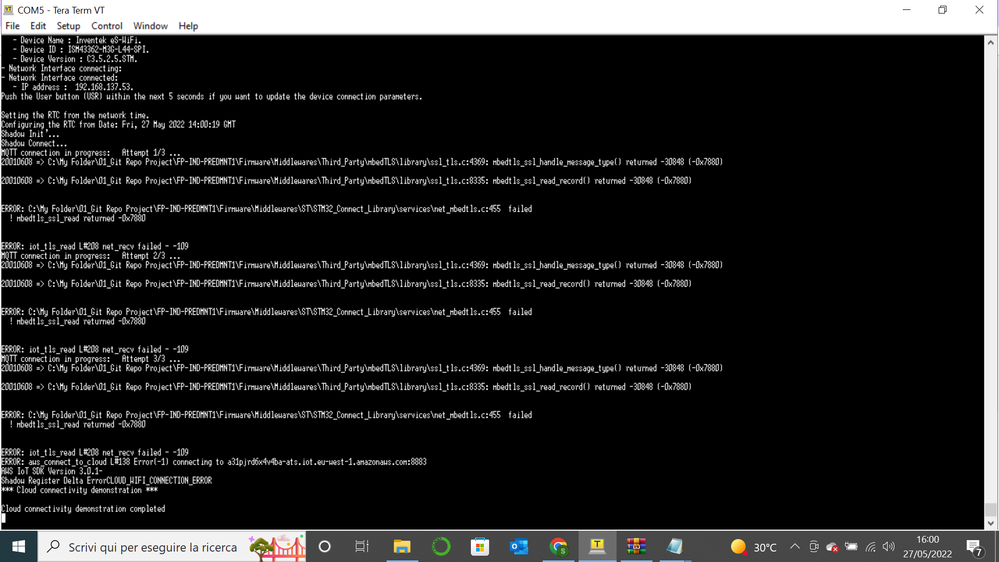

However, when I try to get the board to connect using TeraTerm according to the instructions described, I get the error below:
Frankly, I have no idea how to fix it, so I really hope you can point me to a solution.

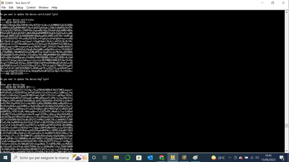

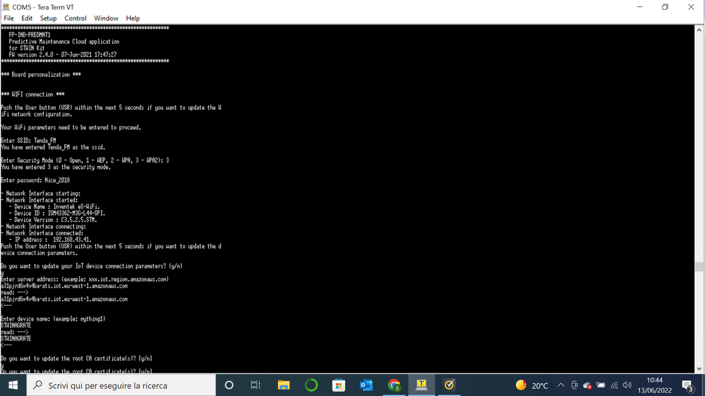

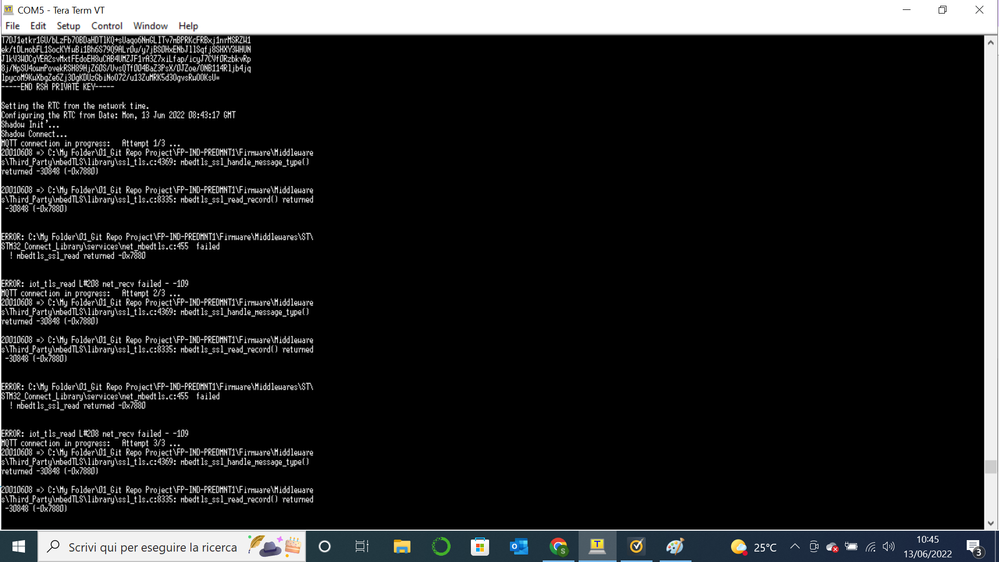

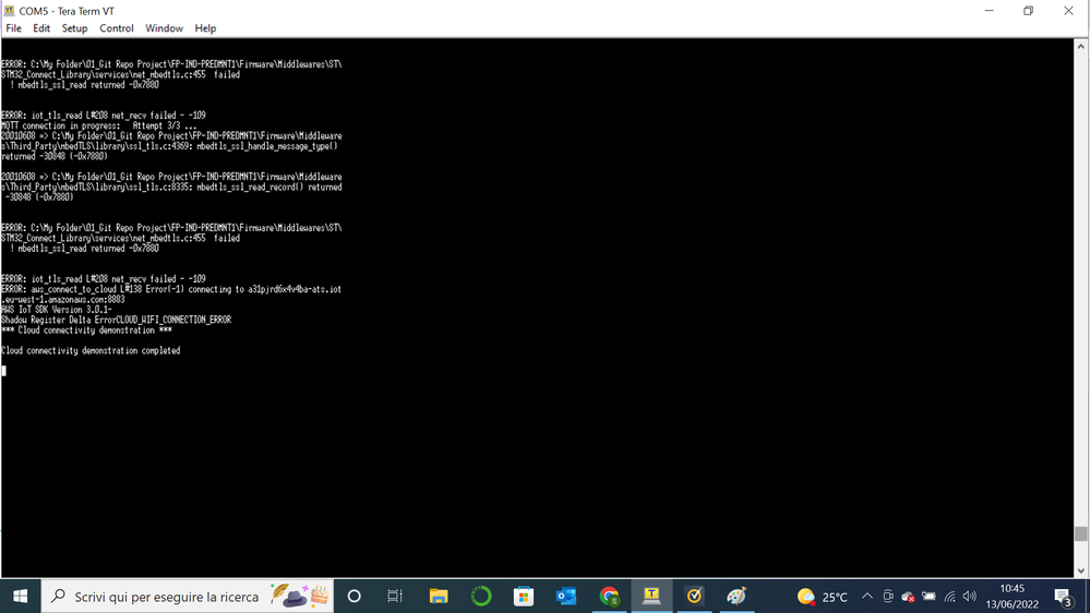

Clearly I pressed the USR button to insert the certificates, below I report the complete log:
