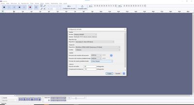

what happens for which I flashed the .bin on the board and then used the STCube, is because at first I tried to see if it worked, when connected to the PC it recognizes the board as a microphone, but I try to make audio recordings and it does not capture no sound (perhaps the STEVAL-STWINMAV1 is not working correctly), plus something strange that has always happened to me is that, unlike the SensorTileBox, when I connect the SnesorTile to the PC, the folder with the data that has been saved does not appear.
The problem is that it is recording audio from the SensorTile mic, but it is not recording from the mic array.

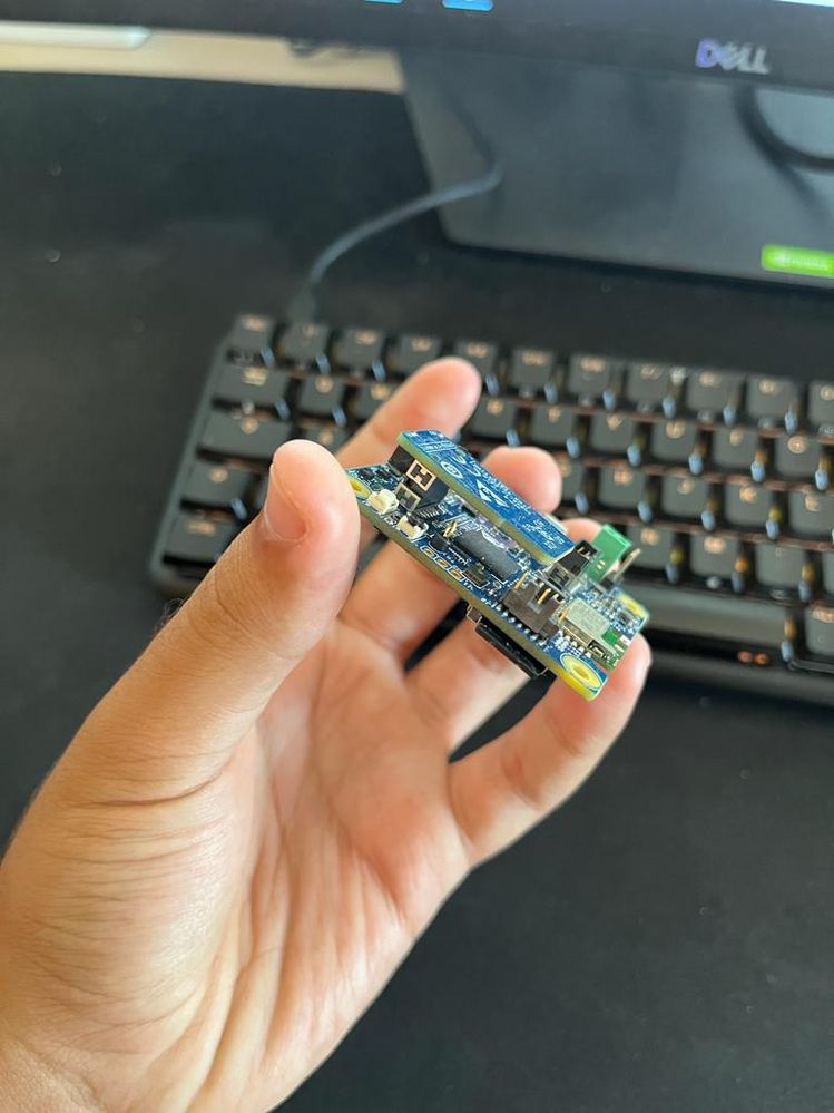

(maybe post a photo of the setup)
Niccolò
Captura de pantalla 2023-09-10 123827.jpgWhatsApp Image 2023-09-10 at 12.34.30.jpeg
I don't know if there is anything else to do, but from what I read in the manual it was just to connect the microphone array to the CN4 of the board (SensorTile).

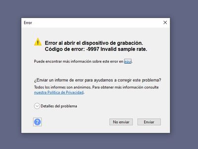

I follow the indications in this pdf but I get this error when recording:
