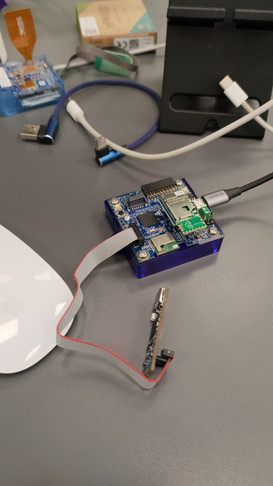

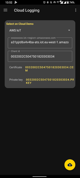

Good afternoon!  I used an example from the link https://www.st.com/en/embedded-software/fp-ai-predmnt2.html   However, the card does not connect to the cloud, I have already downloaded the certificate and private key and it gives an error.

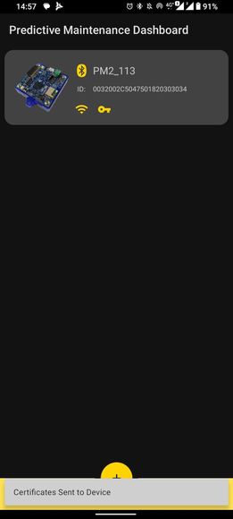

have you already had a look into the FP-AI-PREDMNT2 Quick Start Guide?
Pay attention to the full procedure described in slides 14-16: you are using the wrong certificates. The right ones  must be downloaded from the ST BLESensor Classic app only by selecting from the menu Board Configuration > Board Security > Certificate Request, and then select Predictive Maintenance Cloud Dashboard.
Please refer to the full procedure cited above.

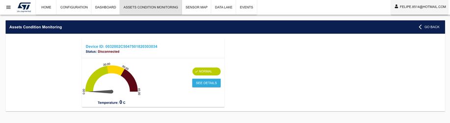

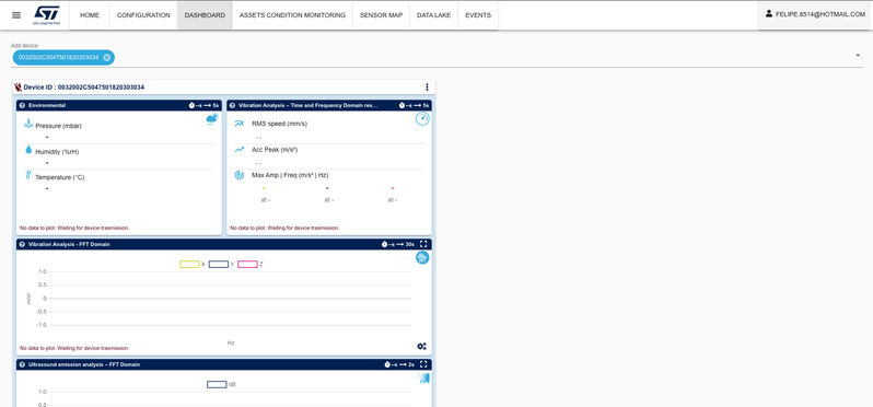

I did the test and it still doesn't send the data to the platform
Hello @Felipe_Nascimento
Once you ended the setup, you must press the USR button to start streaming data. Can you check if now it works?
I noticed that this last step is not written in the Quick Start Guide. I can open an internal ticket to solve this documentation issue.
Let me know if now the demo is fully configured and working.
