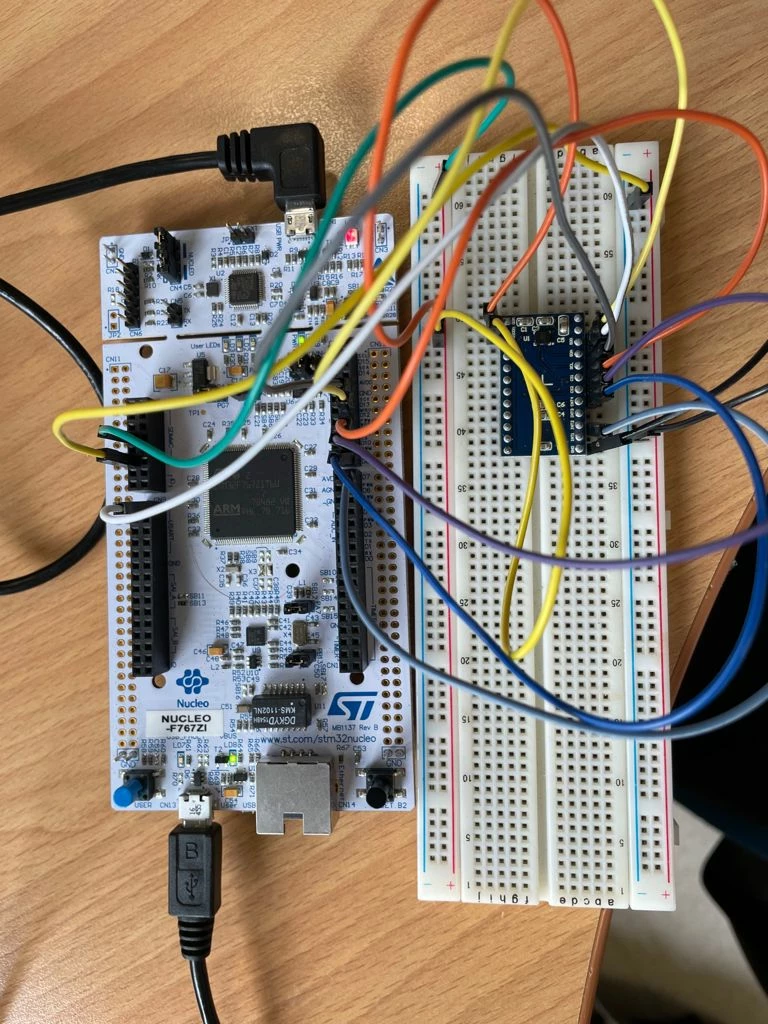

I am writing a code to initialize the BMI055 IMU on my STM32F765. To do so I am using the HAL libraries to enable the SPI connection through DMA and the drivers provided by Bosch: bma2x2 and bmg160.
The two sensors work perfectly when only one of the two is enabled, but together they don't work.

For brevity, I'm not writing here also the gpio initialization, the spi etc. However, when only one sensor is enabled, everything works. When together, problems start at the initialization level: I can't read back for example a proper bandwidth for one of the two sensors.
I'm not sure if the problem is at the sensor level (so the way I am initializing the peripherals) or at the microcontroller level (maybe some errors in the spi initialization, etc).
I hope someone can help to find the problem.

The problems start already at the initialization level. Actually, if I enable the bma2x2 before the bmg160, I get problems in the bmg160 initialization (E.g. I read, and probably write, an incorrect bandwidth on the sensor's registers).
If I initialize the bmg160 before the bma2x2 (as shown in the code), the two sensors get initialed properly but (assuming I don't enable the bma2x2 interrupt) the EXTI callback on pin 14 (bmg160) is not called anymore after few loops, and the code gets stuck somewhere.
If I enable also the bma2x2 interrupt, the EXTI for the bmg160 never gets called at all, but the bma2x2 callback "tends" to work. An explanation I was trying to give is that the bma2x2 (accelerometer) should have a much higher frequency (both the sensors are now at their maximum bandwidth), but I'm not very sure that this makes a lot of sense.
NOTE: I really want to stress that the two sensors alone work well and this makes me think that the SPI + DMA is properly set up as well as the two sensors. But there might be a problem in the way I manage the EXTI lines, when there is more than one or maybe the DMA where there is more than one chip-select around.
Thank you very much for your help.

to give more context, the problem is that after a couple of loops the code get stuck on the SPI reading
while (HAL_SPI_GetState(&hspi1) != HAL_SPI_STATE_READY)

good news! (at least partially...)
Our application team tried to reproduce the issue with two of ST sensors, interfacing them via direct SPI to an STM32F7 and using a code similar to yours, and we didn't reproduce it, combining the interrupts in different ways.
0693W00000AM8fpQAD.jpgIf you want, we can send you our adapter with the configuration.
Let us know!
-Eleon
