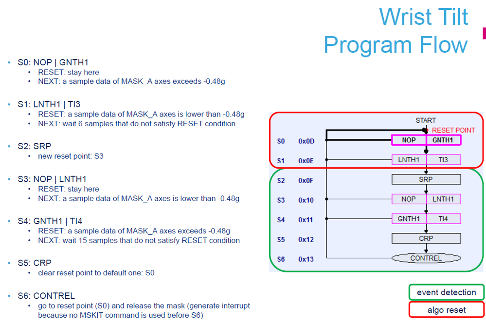

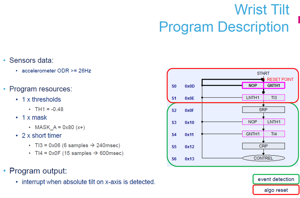

Eleon BORLINI
Hi @sde c.1​ ,
I would suggest you first to check the DT0077 Design tip, that describes some examples for the configuration of the FSM in the LIS3DSH.
A way to deal with the tilt example could be the following one:
By the way, there are a lot of more example for the FSM of LSM6DSO(X) sensors' family, that is similar in the core to the one, but has much more literature: for this, I suggest you the AN5226 application note and the C Github examples.
-Eleon

sde c.1
Senior II
does not work, and examples doesn't help eather.
Any idea why my inititial code does not work ?
This code i created according the above example. Datarate = 100
	buf[0] = CTRL_REG3;
		buf[1] = 0x48;				// INT1 pin active '1'
		if(! lis3dsh_write(buf,2)) 	return false;
		timer_val = TIMX(240);	//time between detection in ms
		buf[0] = TIM1_1_L;
