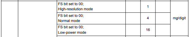

I getting the output now i have configure the register with below details:-
(Reg_Add,Loaded_value)
(0x1E, 0x10) // CTRL_REG0 register
(0x20,0x9F) // CTRL_REG1 register
(0x23, 0x00)// CTRL_REG4 register
(0x24, 0x00) // CTRL_REG5 register
(0x2E, 0x00) // FIFO_CTRL_REG register
while (1)
MemAdd = 0x29; // 0x29 address for the X-Axis
HAL_I2C_Mem_Read(&hi2c3, ACC_ADDRMR, MemAdd, I2C_MEMADD_SIZE_8BIT, (uint8_t *)&rx_data_x, 1, 1000);
MemAdd = 0x2B; // 0x2B address for the Y-Axis
HAL_I2C_Mem_Read(&hi2c3, ACC_ADDRMR, MemAdd, I2C_MEMADD_SIZE_8BIT, (uint8_t *)&rx_data_y, 1, 1000);
MemAdd = 0x2D; // 0x2D address for the Z-Axis
HAL_I2C_Mem_Read(&hi2c3, ACC_ADDRMR, MemAdd, I2C_MEMADD_SIZE_8BIT, (uint8_t *)&rx_data_z, 1, 1000);
HAL_Delay(100);
In the output i am getting the value but it not showing the constant value. It shows 0, 255, 254 at steady position in X and Y-Axis. In Z-Axis it shows 64(or 63,62) constantly. But yes when we move it, it shows the change value as per the movement.
So here I am little bit confused for my output that it is okay or not.
Is it so? or am I wrong?
All correction will be helpful and welcome.
Best regards.
Sachin
Miroslav BATEK
Posted on May 22, 2018 at 21:00
Your measurement is correct.
To get the acceleration value in g unit, you have to firts convert the raw data into signed value and then multiply it by sensitivity defined in datasheet.
So in your case for X, Y axis: 0 ... 0g, 255 ... -16mg, 254 ... -32 mg (basicaly noise). for Z axis 64 ... 1024 mg (gravity).
