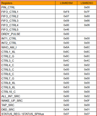

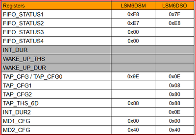

The Register Configuration of LSM6DSM and LSM6DSO -

Kindly help me to fix the acceleration data to get it's Noise level low.
