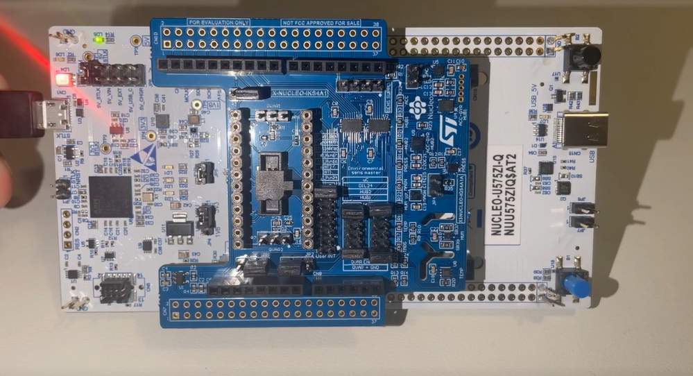

Figure 1: DIL24 adapter boards for MEMS sensors with ISPU

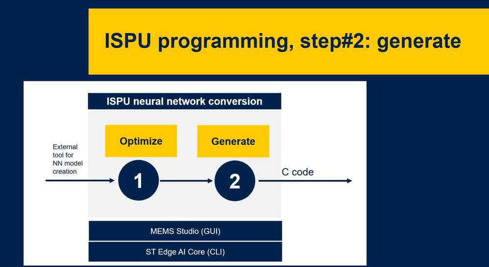

Figure 13: ISPU programming: Step 2 - Generate

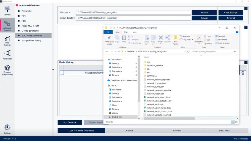

Figure 14: MEMS Studio: ISPU Model Converter tab

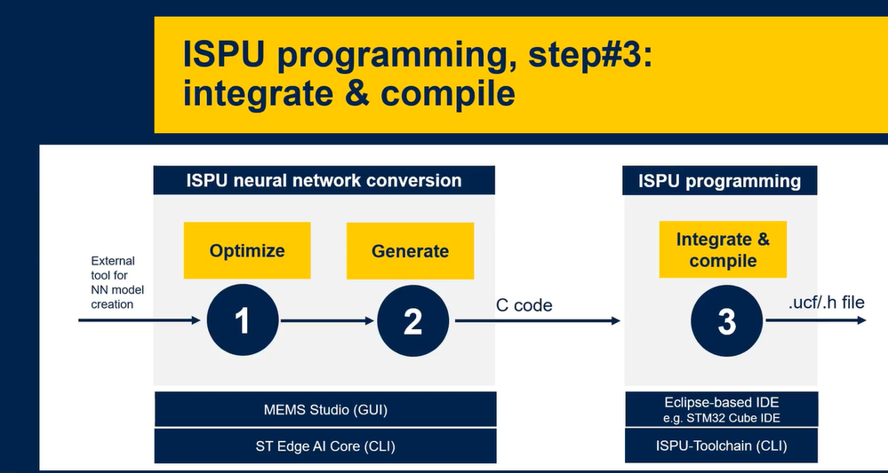

Figure 15: ISPU programming: Step 3 – Integrate and compile

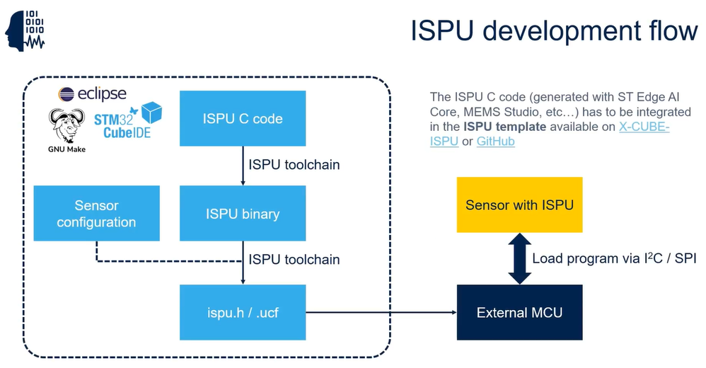

Figure 16: ISPU development flow

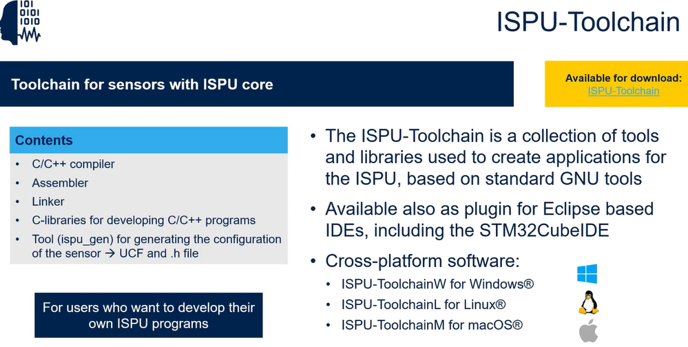

Figure 17: ISPU Toolchain

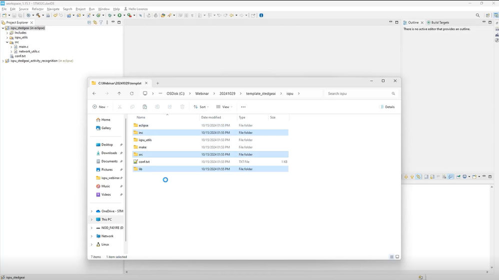

Figure 18: Copy the three folders, i.e. inc, lib, src, generated by MEMS-Studio in the ISPU template before building the project with the STM32CubeIDE.

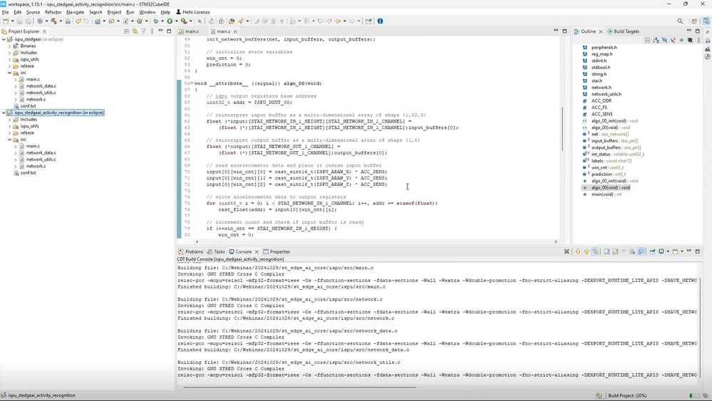

Figure 19: Rebuilding the project in STM32CubeIDE to get the configuration file (.ucf file) for the ISPU
