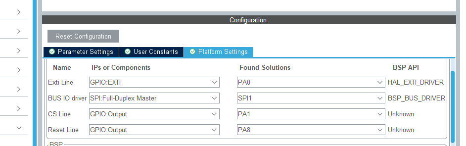

Hi, recently I got a X-NUCLEO-BNRG2A1 and I am trying to use it with NUCLEO-G070RB without success. I have created a project with STM32CubeMx assistance using SampleApp of X-CUBE-BLE2, mapping the pins of the expansion board to my nucleo board as follows:
RST - PA8
SPI_SCK - PA5
SPI_MOSI - PA7
SPI_MISO - PA6
CS - PA1
SPI_EXTI_IRQ - PA0
The project successfully built and uploaded into the MCU, however the application does not do anything it just stuck in the function HCI_TL_SPI_Reset. I have already tried installing the DTM hex file into X-NUCLEO-BNRG2A1, however it does not solve the problem.

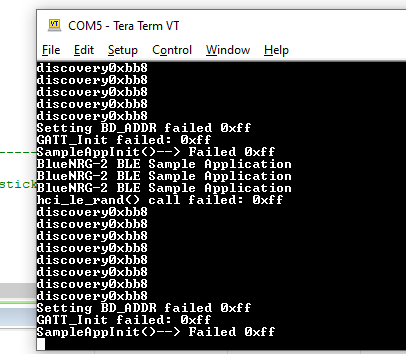

2022-12-20 10:11 PM
hi @PFuen.1 did you resolved the issue? if yes can you help me out with the same. I too not able to even initiate the bnrg2a1, its getting stuck in one of the while loop after getting gatt init failed, bdarr failed.

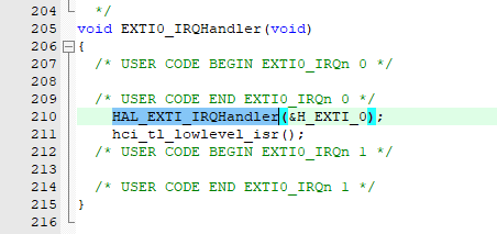

2022-12-21 03:42 AM
I'm attaching the ss for simpler changes which you said . i just wanted to know regarding hci_tl_lowlevel_isr that it is correct ay to call ?

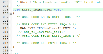

2022-12-21 03:45 AM
2022-12-21 04:06 AM
still im getting same errors.
2022-12-21 08:05 AM
@satyam9896 Hmm no, remove "hci_tl_lowlevel_isr" from there. When using the HAL it should be done with the function HAL_EXTI_RegisterCallback. You have to only check that you have this in "stm32xxx_it.c":
void EXTI0_IRQHandler(void)
HAL_EXTI_IRQHandler(&H_EXTI_0);

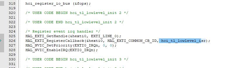

And that in "hci_tl_interface.c", the function hci_tl_lowlevel_init has attached "hci_tl_lowlevel_isr" into the interrupt:
void hci_tl_lowlevel_init(void)
tHciIO fops;
/* Register IO bus services */
fops.Init = HCI_TL_SPI_Init;
fops.DeInit = HCI_TL_SPI_DeInit;
fops.Send = HCI_TL_SPI_Send;
fops.Receive = HCI_TL_SPI_Receive;
fops.Reset = HCI_TL_SPI_Reset;
fops.GetTick = BSP_GetTick;
hci_register_io_bus (&fops);
HAL_EXTI_GetHandle(&hexti0, EXTI_LINE_0);
HAL_EXTI_RegisterCallback(&hexti0, HAL_EXTI_COMMON_CB_ID, hci_tl_lowlevel_isr); // <--- THIS
HAL_NVIC_SetPriority(EXTI0_IRQn, 0, 0);
HAL_NVIC_EnableIRQ(EXTI0_IRQn);

2022-12-21 10:06 PM
hi, i have done all three changes done but still its showing same errors.
