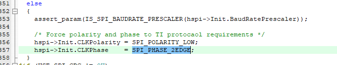

The ideas here were very useful! They took care of a lot of the issues I was having, but I still had a couple more issues. For the benefit of others, I will list them here:
  • Make sure all your SPI settings are correct! Refer to the Central.ioc file in the example project on github if you are adding the Central demo to your own project (I had the stm32WL55 nucleo, not the standard L-series Nucleo, but I was still able to use the Central sample application using CubeMX)
    • SPI Data size defaults to 4, needs to be 8 (SPI_DATASIZE_8BIT)
    • Adjust the prescaler according to your CPU speed so that the baud rate is 2 > x >= 1mbps. I have 48 MHz, so SPI_BAUDRATEPRESCALER_32 gave 1.5 mbps, which works great! using prescaler of 16 did not!
  • I set EXTI pin to pulldown, so it couldn't accidentally be left high and cause spamming of interrupts
  • In GPIO section, click NVIC tab, and enable EXTI Line x Interrupt (where x is the pin number that EXTI pin is connected to on your board. On the L-series nucleo, it seems to be PA0, on mine it was PB1, so I selected EXTI Line 1 Interrupt). This creates and enables the appropriate callbacks that others have manually added.
  • Set ble RESET and CS gpio output pins default to High
Good luck!
