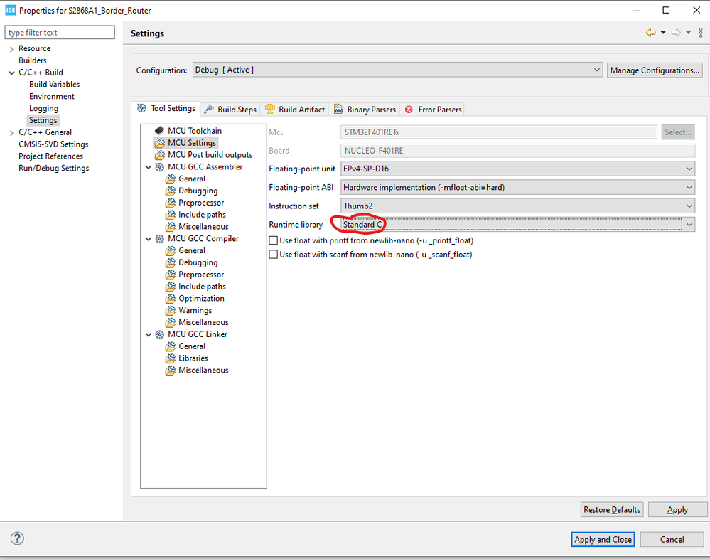

I started importing X-CUBE-SUBG2 software in to STM32cubeIDE 1.6.0. I am getting lot of errors when I compiled for Nucleo-F401re. Binaries works as explained in user manual. But, whenever I import the project, I am getting errors. It looks like tools issue. Any idea?

there is an issue with regards Contiki-NG based projects and the default library of the new toolchain. Either you change the compiler like you said or just use the standard library (see attached picture)

I found the issue. If I change the GNU tools to GNU Tools for STM32 7-2018-q2-update software gets compiled correctly.
GNU Tools for STM32 7-2020-q2-update have some bugs. Can someone tell me what is the stable GNU Tool for STM32
