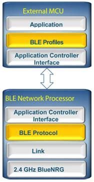

Thanks. However, we are using an NXP i.MX RT1060 MCU to interface with this module, not an ST MCU. It is unclear on how to use the UART to do Bluetooth communication. How do you do this? Can you provide examples or documentation on this, specifically on how to communicate with an MCU other than an ST?
We don't want to write firmware for the BlueNRG chip itself, we just want to know the easiest path to talk to the module via UART, i.e. "Hello World" example? We just want to send and receive messages.
Regards,
NXP MCU will need to control the BLE chip thru the standard HCI/UART interface.
MCU is a application processor and SPBTLE-1S is the network processor, like:
In the picture, ACI is the HCI interface extended with ST vendor specific commands.
Please refer to ACI documents under BlueNRG GUI package: C:\Program Files (x86)\STMicroelectronics\BlueNRG GUI 3.1.0\Docs\gui_aci_html\
BlueNRG GUI software package:
https://www.st.com/en/embedded-software/stsw-bnrgui.html
