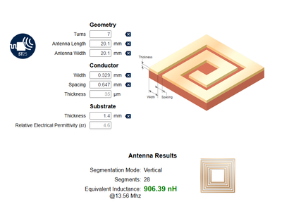

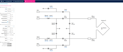

Hmm, well the way I designed this is I used the default matching network for the ST25R100, the one that is given by the NFC Tuning Circuit tool.
And the I remade the antenna, to fit in my enclosure with the same equivalent inductance.
How or what do I change best to make sure it can write through my enclosure, I know this is not a easy question and I probably need to measure a few things, if you know of handy sources I definitely have a read.
Is there like a procedure or something to define the values of the matching network?
Also attached a few pictures of the case in question. Its a plastic case .
Kind regards,
William

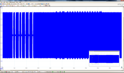

Hello William,
30Vpp is already not too bad.

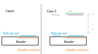

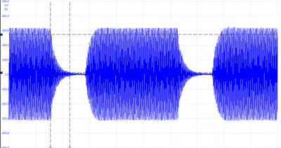

Can you share a scope shot of NFC field close to the reader using an ISO calibration coil? (if no calibration coil is available, a wire loop in ID1 size also does the job.
And maybe one where the pick-up coil is close to the tag (e.g. 4cm, 2cm and 1cm between tag and reader).
Trigger on the reader command (pulse width trigger, negative pulse, between 500ns and 15us).
You should see something like this:
I would be specially interested in the rise and fall time of the reader signal:
BR Travis

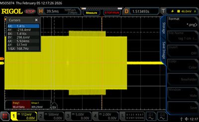

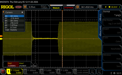

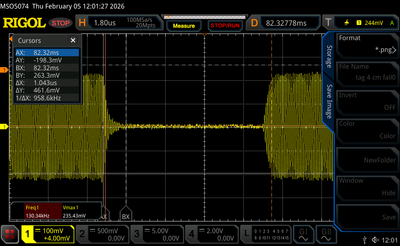

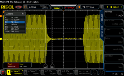

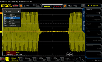

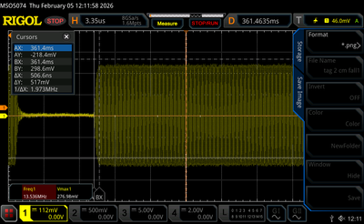

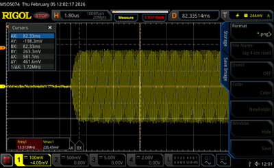

Hi, I did some measurements.
After these last changes I can read successfully, I just need to hold it longer still to the tag.
If I want to optimize this further should I change anything to the PCB design for the final sample?
Here are my measurement results:
No tag fall:
not tag rise:
Tag 4cm fall:
tag 4 cm rise:
tag 2 cm fall:
tag 2 cm rise:
tag 1 cm read:
Thank you soo much!!!
Kind regards,
William

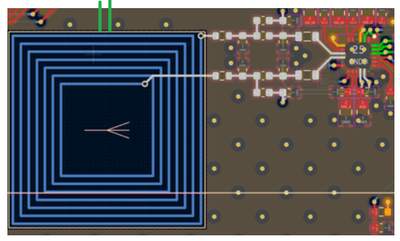

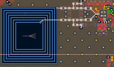

Hello William,
Is the antenna on all sides completely surrounded by metal?
Maybe you can introduce a cut/slot on one side to the boarder of the PCB.
You might need to re-tune the antenna but it should greatly improve the reading distance.
You can also see that your rise and fall time is quite sharp which hints to a low Q-factor that could be originated by high eddy currenty.
BR Travis
No the case is all plastic, there is a small piece of metal on the left for the battery connectors.
Hmm all right, I'll look into it!
Kind regards,
