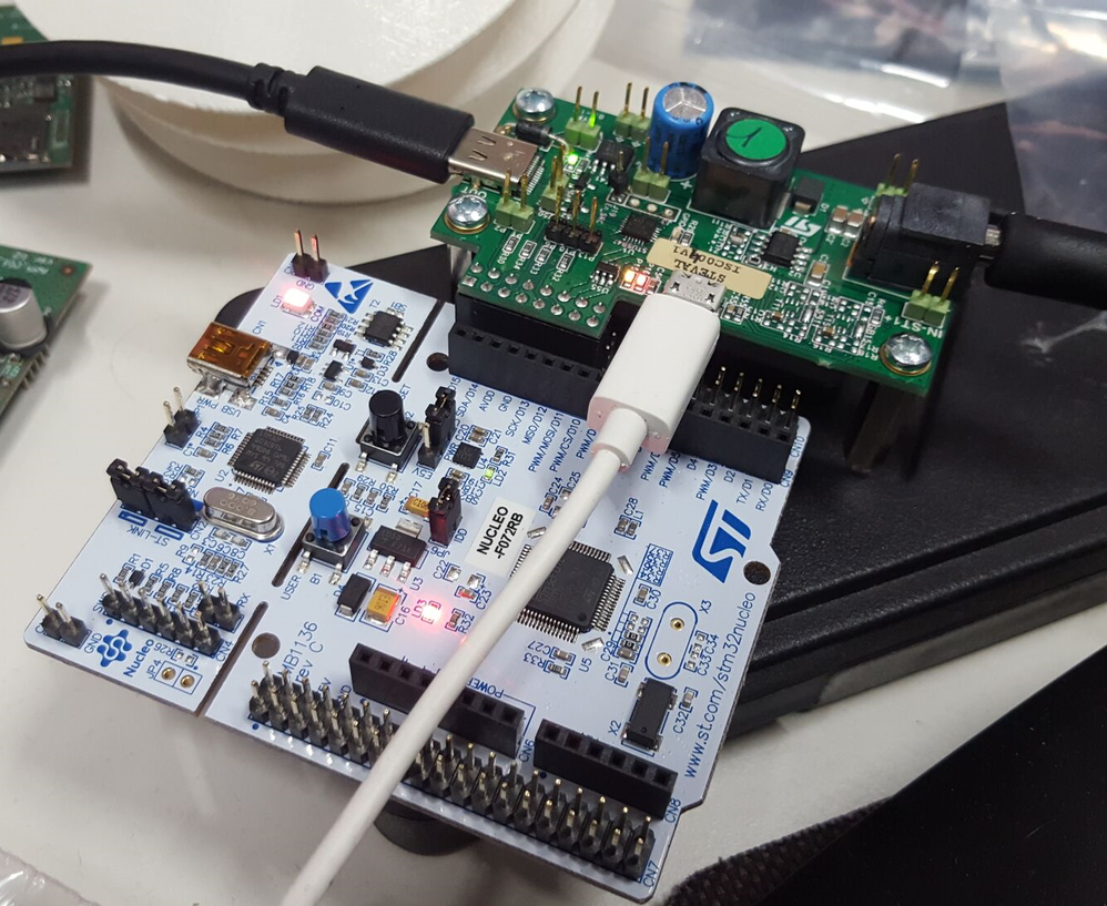

I have assembled the STEVAL-ISC004V1 with nucleo board in order to be able to use the gui. I now connected the boards like this to the PC using both USB C ports:

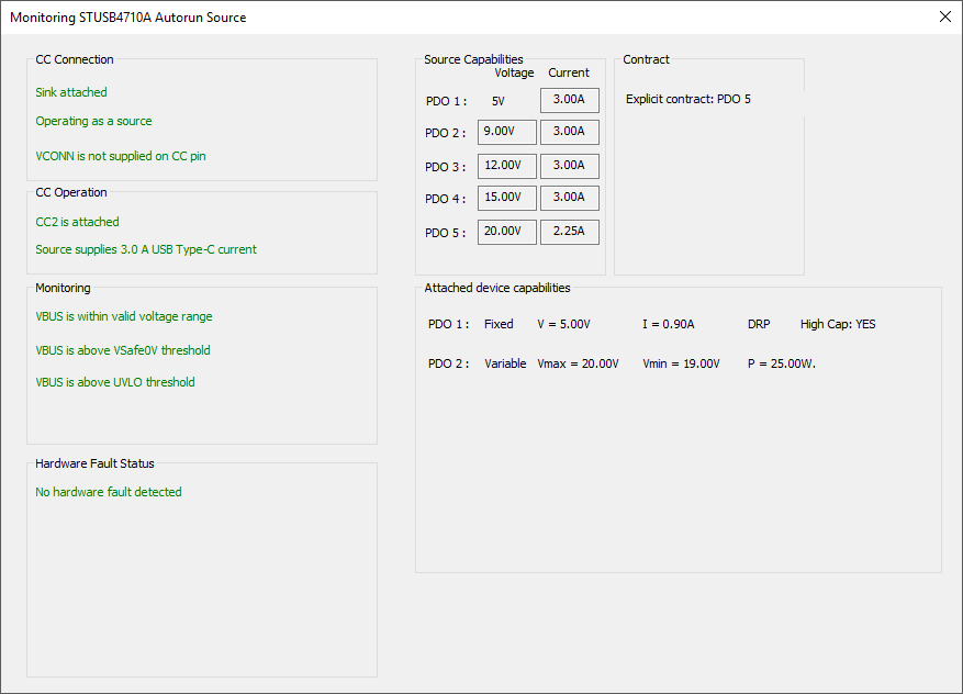

It seems like the contract is accepted, but then it disappears? Also, does it really agree for PDO 5 for a sec? In the video I try both USB C ports on the Dell 7730 unit.
Benoit FORET
​Hi Lukasz,
the connection looks good. But the behaviour is typical of STUSB4710 going into error recovery (fault condition => terminate connection => restart => re-negotiate => fault etc...) because VBUS voltage can't meet the agreed voltage (20V in your case) within the right amount of time defined by the standard (5V to 20V transition is less than 270 ms). You should monitor VBUS on the scope and check it meets the UVLO / OVLO threshold at 20V (18V/21.6V). Maybe you can try to enlarge the UVLO/OVLO to +/-20% to give more margin in case the power supply you use is weak. See the result with a 2018 HP EliteBook840 G5.
Benoit FORET
Benoit,
You are right, it was my bad- I have manually set the current limit to 100 mA on the AC adapter. After turning it up to 2A here is the result:

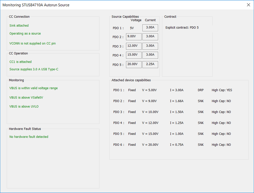

Benoit FORET
What is your laptop' battery State Of Charge? I think bellow 20%, it will give an idea how the laptop charging algorithm behaves with a Universal Power supply (I mean non-DELL). I believe it may not charge at the fastest way, but charge anyway (close to 1.2A). As you can see, mine has several 15W profiles (Buck-boost inside) which make it quite universal, but this is half the original HP AC adapter. And yes, when battery is low, the laptop is sinking about 100mA less than the negotiated contract, which is a good implementation. Bye
