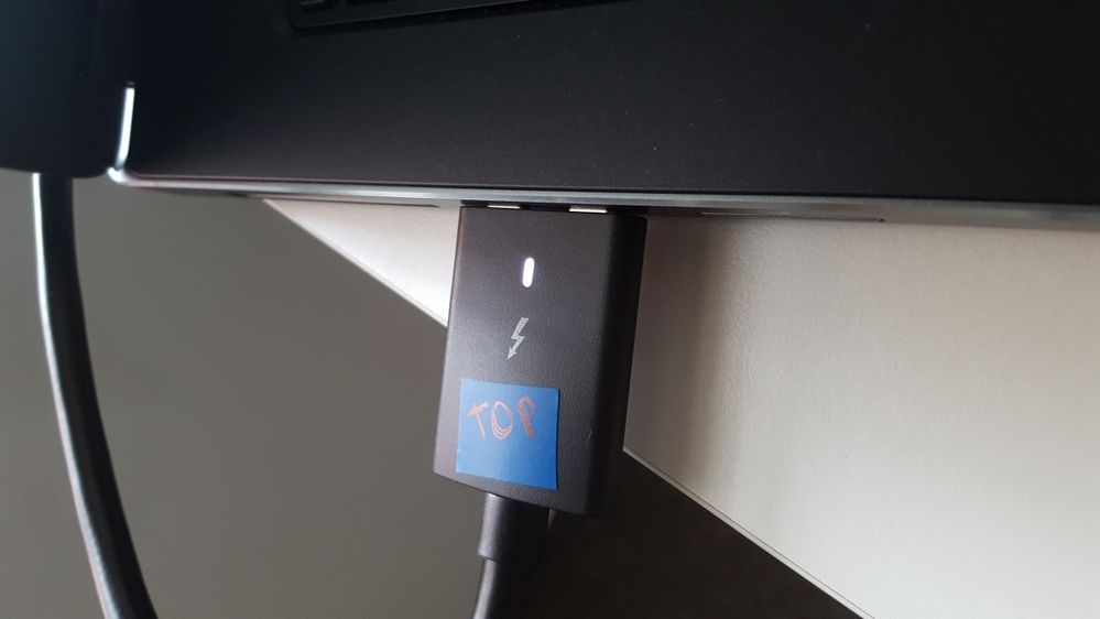

The Dell 7730 machine is a very complicated one. In terms of USB C it doesnt work 100% yet, I am in constant support with Dell. But no matter that, the docking station is able to charge the laptop. The PC consists of 2 USB C ports next to each other. The dedicated docking station for it is the TB18, which consist of this mutant 2x USB C plug:
I dont know this for sure (as it is not written anywhere, and talking to Dell support about such things is pointless, would probably need to talk to the core developer...), but it is designed like this probably because the 240 W you have mentioned is way above the spec of a single USB C cable. But- one can still charge the laptop using a signle USB C cabled docking station, like the one made for small dell latitudes. It simply takes longer to charge then. Another interesting thing is that when the STUSB4500 was connected to the docking station, it reported 5V only at one of the available USB C plugs. No voltage present on the other...

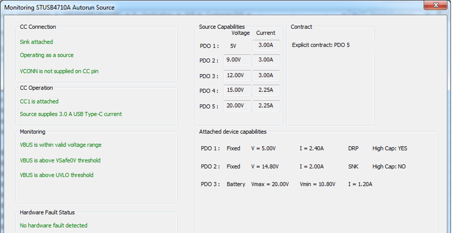

I can also recommend the STEVAL-ISC004V1, which is a certified ready to use SOURCE supporting (5V/9V/12V/15V/20V). You can use it as a reference. There is also a GUI including a DASHBOARD running on NUCLEO, which reports to you the power profiles of the SINK you attach to this board.
See bellow MacBook power profile reported by the GUI. Similar test could help to understand your laptop requirements

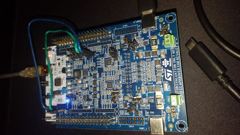

Hello Benoit, thank you for answer. Ok so I took the P-NUCLEO-USB002 and connected the wires and jumpers like advised in the manual. Bellow is a picture:
I connected to the serial console, we are good at this point:
P-NUCLEO-USB00x Demo v1.0.4
Console v0.4
Type help for a list of commands.
STMicroelectronics
Copyright (c) 2017 - All Rights Reserved.
The manual proposes to connect both USB C connectors on the PCB together. I understand that they should negotiate which one will be the sink, and which one will be the source. But when I do that:

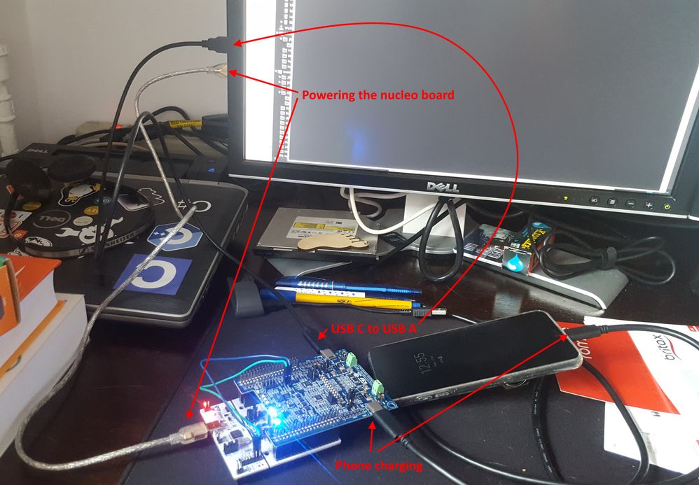

Similar result... So Now I connect the USB C 0 of the P-NUCLEO-USB002 to my laptops hosts USB 2.0 socket (using USB C to USB A 2.0 male plug):
*** [0] attached on CC1 (Sink)
Seems to be working. Now I connect a mobile phone to the other connector of the P-NUCLEO-USB002 using USB C -> USB C cable:
*** [1] attached on CC2 (Source)
*** [1] detached
*** [1] detached
*** [1] attached on CC2 (Sink)
*** [1] selected cap #1
Some weird activity but works eventually, the phone is charged.

​Lukasz,
I'm not an expert of this board, but please note it is not very convenient for emulating Power Delivery SOURCE, as you need to provide appropriate voltage to make it work above 5V.  It is good as a SINK for asking SOURCE profiles.
For above first 2 cases, it looks to go in error recovery, certainly because the 5V is not available on VBUS_SRC.  Please check to connect jumpers JP400 and JP401 (which allow to power VBUS_SOURCE from the 5V from the NUCLEO mini-B. It should solves your issue. Then, you can test with your dockin and your laptop, and enter command p [port number 0 or 1]. see >help command
Benoit
Benoit, thank you for answer. I did not close the JP400 and JP401 because they were open in the manual. Also the phone was changed, so I thought that was not the case. But yes, after closing them both I was able to successfully connect the USBC 0 and USBC 1 connectors of P-NUCLEO-USB002 board together:

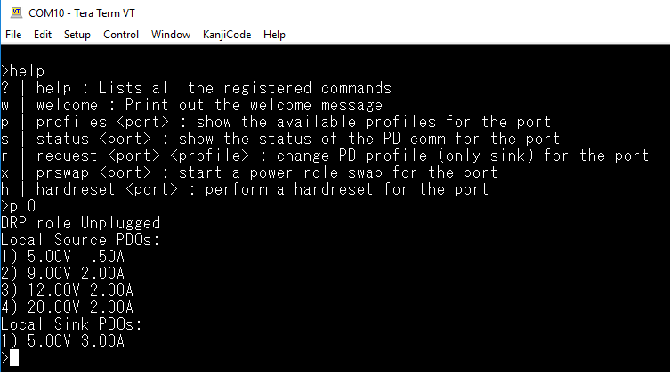

By default, the P-NUCLEO-USB002 virtually offers the bellow 4 profiles as a SOURCE,
And a single 5V profile as a SINK
That’s why when you connect both port of the P-NUCLEO together, they both connect at 5 (cap #1 => 5V/1.5A )
