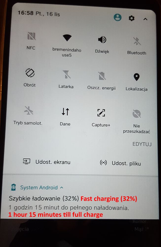

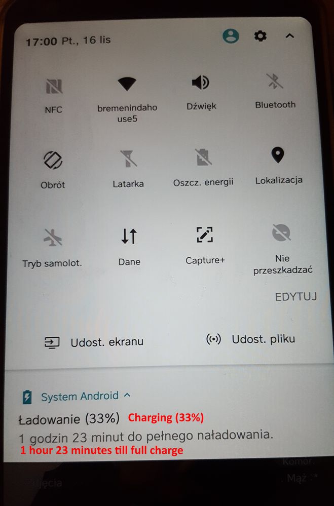

As for the mentioned charger, it consists of 2 ports: USB A and USB C:
If I connect my android phone to the USB C (USB C ,-> USB C cable), I get a system message that fast charging is in progress:
While if I connect it to the USB A ports (using USB C to USB A plug cable), I get regular charging:
This would suggest that the phone made a handshake with the charger over USB C. I wonder why didnt this work with the eval boards.

To check what is happening with STEVAL-ISC004V1, I recommend to use the associated GUI (STSW-STUSB001) (STM32 NUCLEO board required to run it). The GUI include a Dashboard that collects the SINK profile, so that you can check consistency with the SOURCE profile. It also report the agreed contract between the 2 devices.
Also please note that your charger also support former Qualcomm QC3.0 on top of USB PD, which is likely the fast charge protocol also implemented in your smartphone. This protocol is not implemented on the eval board you have.

As for the charging the phone, what you say is probably right, but keep in mind that I was able to charge this exact phone through P-NUCLEO-USB002 (profile 1, 5V in console). So it seems the phone does support usb PD.
