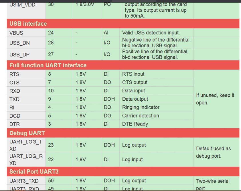

I have connected Stm32f407 discovery board with Simcom A7670 via USART6 but in asynchronous mode, connecting UART Tx of A7670 with USART6 Rx of STM43f407 discovery board and UART Rx of A7670 with USART6 Tx of STM43f407 discovery board respectively.
I am using STM32CubeIDE, so I have enabled USART6 Global Interrupt in NVIC Serttings and added USART Rx with mode Circular in DMA Settings and using 115200 bits/s as default. Hence when I burn my program into my MCU, using Putty connected with PC with 115200 Serial connection, doesnt shows any thing into its screen. Here is my Code...

The code should work if UART is properly initialized (HSE value)
Also A760 has 1.8V levels UART
Note that the code initializes UART in DMA mode but HAL_UART_Transmit(...) dont uses DMA or interrupts. Is the blocking version of transmit
