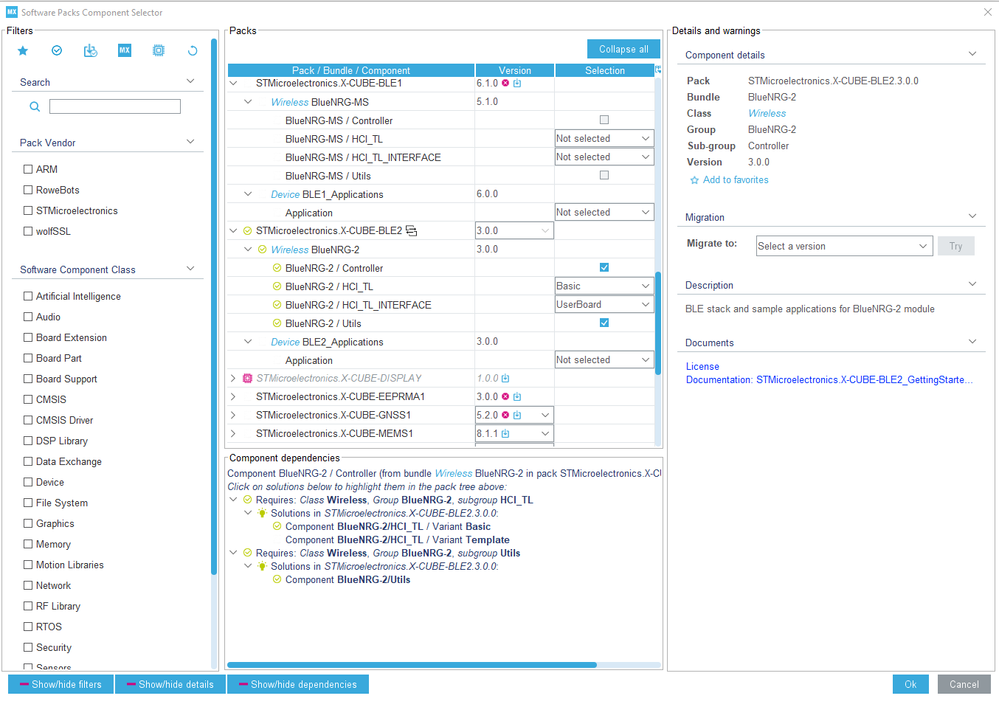

I picked up a X-NUCLEO-BNRG2A1 (Extension board Lot:2040 for the Nucleo-64 boards), and I am trying to communicate with it through a Nucleo-F411RE Board. I basically generated a project template through CubeMX for the STM32F411RE and included the BlueNRG-2 (X-CUBE-BLE2) Pack to include Bluetooth HCL/ACI APIs along with the project template.

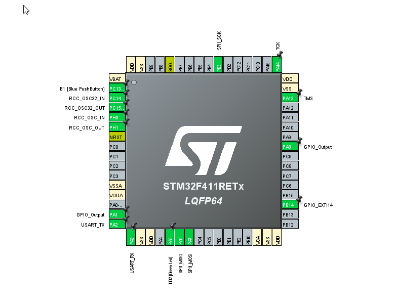

0693W000008wLRGQA2.pngI also assigned in CubeMX (in the Software Packs section) that I will be using SPI1 bus, GPIOB Pin 14 for the SPI EXTI Pin, GPIOA Pin 1 for the SPI1 CS pin, and GPIOA Pin 8 for the HCI_TL_RST Reset Pin.
I also configured the SPI1 bus to be Full Duplex Master, Prescaler = 128 (to obtain 781.25KBit/s baud rate), CPOL Low, and CPHA = 2 Edge (based on the configurations found in an example project under X-CUBE-BLE2\3.2.0\Projects\NUCLEO-L476RG\Applications\SampleApp).

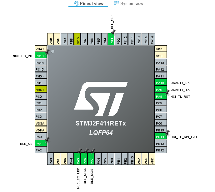

concerning the pinout configuration, if you want to use the PB14 as SPI_IRQ, you should also bridge the PIN 28 of the CN10 on the Nucleo board with the PIN 28 of the CN10 on the X-NUCLEO-BNRG2A1. Otherwise, you can use PA0 and you don't need any bridge.
In any case (either using PA0 or PB14 with the bridge), please, do not forget to enable the corresponding interrupt line from the NVIC view in STM32CubeMX.
The following picture shows the complete pinout configuration (please, note that the USART2 is used).
0693W000008wYfbQAE.pngAnyway, you can find all the information on how to setup a project for your X-NUCLEO-BNRG2A1 in the Getting Started Guide included in the X-CUBE-BLE2 package.
Also, for your project I'd suggest to use the latest STM32CubeMX v6.2.0 (available on st.com) and the latest X-CUBE-BLE2 V3.2.0.

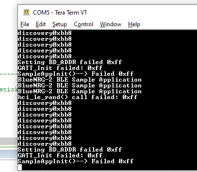

satyam9896
hi , @RrW​ did you resolved the issue? if yes can you please help me out with the same bnrg2a1 errors?0693W00000WLbcvQAD.png0693W00000WLbcbQAD.png
