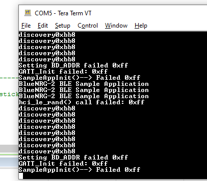

satyam9896
hi, @Roberto Giovinetti​  did you resolved the issue ? if yes then can you please help me out with bnrg2a1. here below is are the errors im attaching.0693W00000WLbbJQAT.png
Roberto Giovinetti
Hi @satyam9896​
I can't help you: Unfortunately, this project was abandoned and I no longer pursued the development.
I am sorry I cannot be of any help.
Roberto
