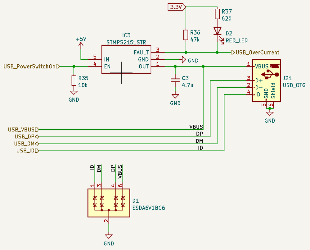

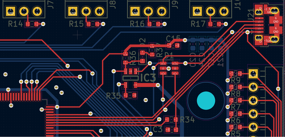

I tried to replicate the usb part of NUCLEO-F439ZI dev board to a project, without success.
FabioVasconcelos
I'm using vbus to power supply the MCU, through a voltage regulator.
For the MCU I'm using the stm32f427, not the 39, as in the development board, but they seemed compatible with my project features.
When I connect the board to my laptop via USB, the overcurrent led turns on, and my operating system (ubuntu) does not detect any new USB device.

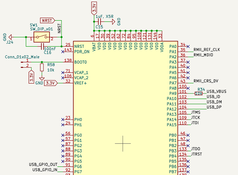

Chris1
Senior III

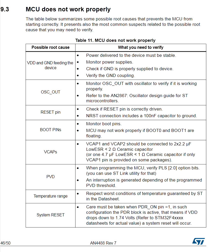

Is there actually nothing connected to the VCAP pins as it appears above?
That would be a problem...

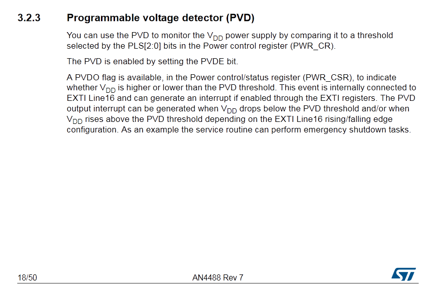

It seems that I'm missing VCAPS and PDR_ON, I will try both!! Thank you
PVD I didn't understand what they mean, maybe does not exist in stm32f427?
If you have not enabled the PVD, I don't think that it is of concern.

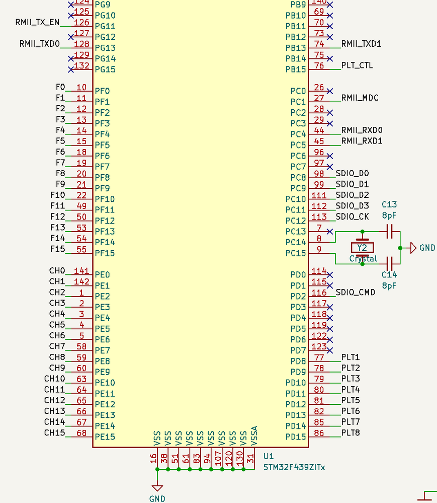

I figured it out.
I'm missing a crystal in PH0 and PH1, not it's working!
