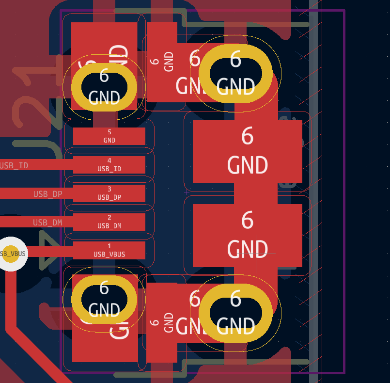

Your J21 usb con is faultly connected, too USB data lines need wire as diferential pair on pcb.
Hello @MM..1​,
What do you mean by a faulty connection?
The data lines are differential, and according to kicad calculator they have ~100Ω (Hope is it not the cause).

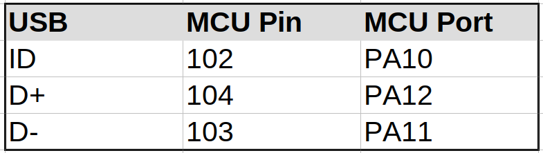

I also have 5V in my voltage regulator, so it seems that the power lines are correct, then are connected according with the table below:
GND pin is open
ah okok, sorry, I got what you mean, I hide de ground plane to not have too much entropy in the images. The GND is connected to the ground plane, so it seems that all the connections are ok right? Thanks!
Then check if con is right orientation plus if you plan connect into PC you act as device and power switch IC3 need off or unsloder.

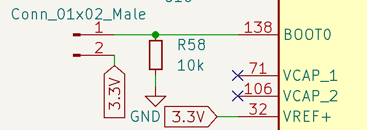

I figure that the overcurrent led turns on because of boot0 is connected to 3.3V, when I change boot0 to gnd, the led turns off. I will need it later, but for now, I will not take that for the equation.

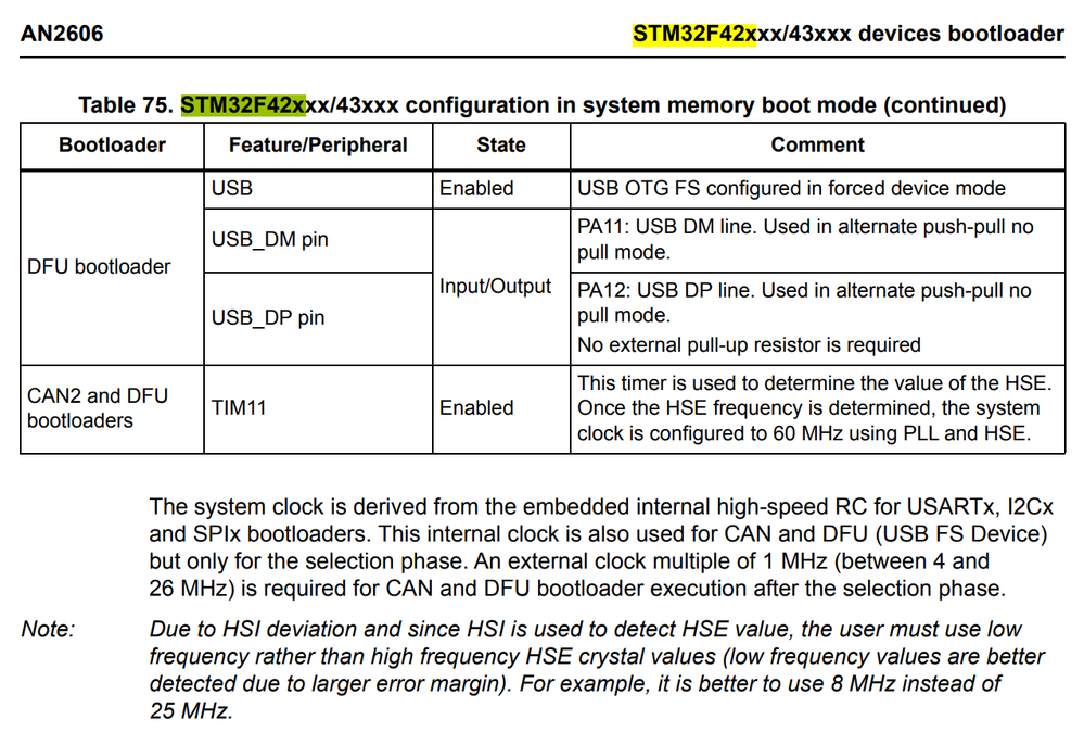

And for use DFU detection is defined in AN2606 plus

I have PA11 and PA12 correctly connected, I hope but dfu is not working.
Maybe the first line means something? USB OTG FS configured in forced device. What does this mean?
My boot0 connection:
