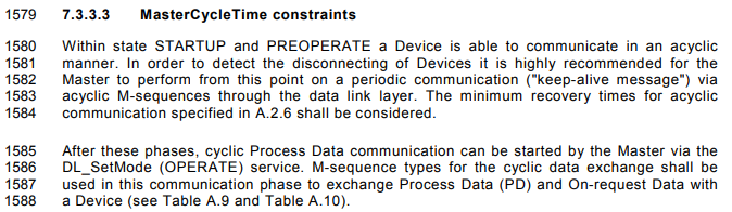

I believe you have not entered into OPERATE mode as the cyclic data exchange is not started.

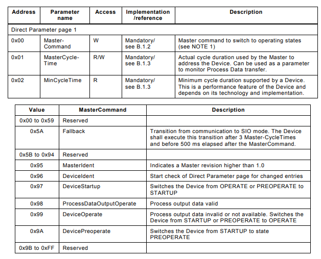

Have you tried writing the value "0x99" to address "0x00" (MasterCommand)?

1) The only way I can think of to check if the device is in operate mode is to send M-Sequences of type 2. This sequence will only trigger a response if you're indeed in OPERATE mode.
2) Regarding the TYPE_2_V, Table A.1 shows which values you should set according to the sequence type. It only asks for major version of sequence type (0,1, 2) and not its subtype (*_[1,2,3,..,V]).
3) You might have gone lucky by having an answer with MC = 0xCA, the datasheet of your sensor stipulates that 0xCA is the address of the parameter. Given the range of that parameter (>5bits) is an ISDU parameter address (Table A.15). This parameter allows to switch from measurement type to smart-sensor-profile type process data (the two definitions of PD you have at the top of the datasheet). The answer, you get however contains the 3 bytes PD data as it is transmitted at each cycle along the CKS and here with an additionnal OD byte.
4) Regarding the cyclic exchange: The device will never init a cycle and start sending data on its own, the master (your software) is responsible to lead the sensor by operating it in a cycle (and eventually other sensors in the same cycle but different uarts).
This means that you should implement a loop with a timing of MasterCycleTime (in my case for ex. 3.1ms), in each loop, your device has to send an MC + CKT. If your program fails to send a message cyclically or takes too long (>10% of MasterCycleTime) the device will consider that the communication is lost (COMLOST) and will switch back to STARTUP mode, prohibiting you to access to your measurements.
To get my process data I use an ISDU channel, MC = 0xF1, the answer is 4 bytes: 3PD + 1CKS, this should work as well for your sensor.
If you don't have ISDU Support @SLee.7​ , you should be able (untested) to use an MC = [read = 1, comm. channel (process) = 00, address = 0x00] and CKT = [seq. type (2) = 10, ck6]. This message has to be transmitted at each cycle.

I have tried writing to "MasterCycleTime" but the value in it is not updated when I read it.

Are you reading 0x30 for the MinCycleTime ? Your sensor has a 4.8ms min. cycle time, you should try communicating with a loop of cycle >5ms to it. Don't bother writing to MasterCycleTime, but actually reading from it might be more interesting.

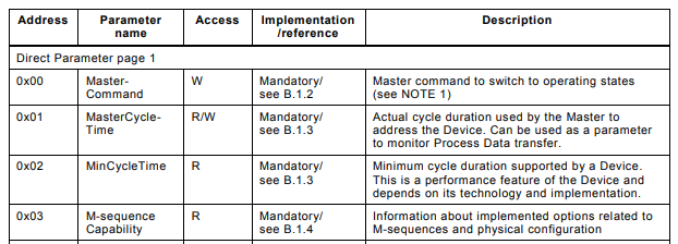

@TSerr.1​  When I read "M-sequence Capability" (0x03), it return a value of '0'. So I thought that other types other than TYPE_0 is not supported. After I look more carefully into the IO-Link specs, I see that this is not the case.

Yes. MinCycleTime has a value of 0x30. When you say communicate, do you mean reading from any parameter or writing to a certain parameter?
Reading MasterCycleTime always return 0x00. Even if I write another value to it, there is no change to the value. Therefore, I try with RevisionID instead, which return with a value of 0x11 (correspond to version 1.1 which is correct). Still no change after I attempt to write a value to it.

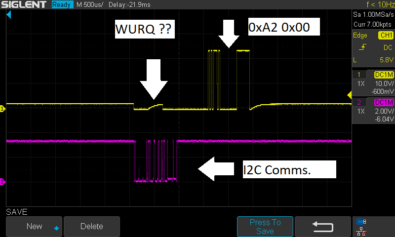

ASanc.1
0693W00000AMU2QQAX.pngHi,
it seems that I've been having problems while trying to generate the WURQ.
In my case, it seem the WURQ has been partially generated and I don't know why.
I attach an oscilloscope capture with two signals: YELLOW => C/Q and PINK => I2C DATA.
In the capture you can see that I made a communication through I2C, then the WURQ seems to be partially generated, and then I write the command 0xA2 0x00
