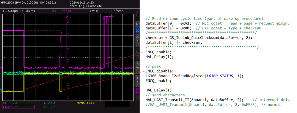

I simply can't figure out how to generate this pulse with my STEVAL-IOM001V1 board. Even the supplied code (en.stsw-iom001) doesn't make me any wiser.

I’ve read your report with the oscillogram with great interest. In fact, the data sheet does not explain how the WURQ can be generated. The pulse strength after an I2C command depends on the pre-flight voltage at C/Q and therefor it is useless as WURQ. After many attempts, I found a solution. I have tested it with the inductive sensor AI402. The effect is reproducible, but I am not sure how it works. What was your solution? It is ST's responsibility to make this clear in the data sheet.WURQ_1.PNG

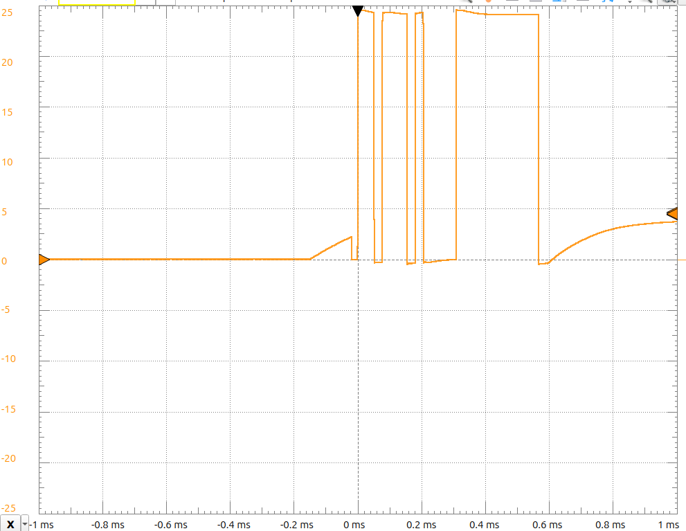

Hello, recently I got my hands on an STM32 Nucleo-F401RE with an STEVAL-IOM001V1. The goal is to communicate with a digital flowmeter, the Festo SFAH-10B. This is my first time working with this specific protocol, and as someone without much experience in protocols, I find it very tough. I’m trying to follow the instructions and the code you provided earlier, but I’ve hit a wall.
MOTREN
Hello, after many attempts, I think I have managed to generate a signal similar to the WURQ, but I still don’t get any reply from my sensor (Festo SFAH-10B flowmeter). Do you have any suggestions?Screenshot from 2025-10-31 14-01-20.png
