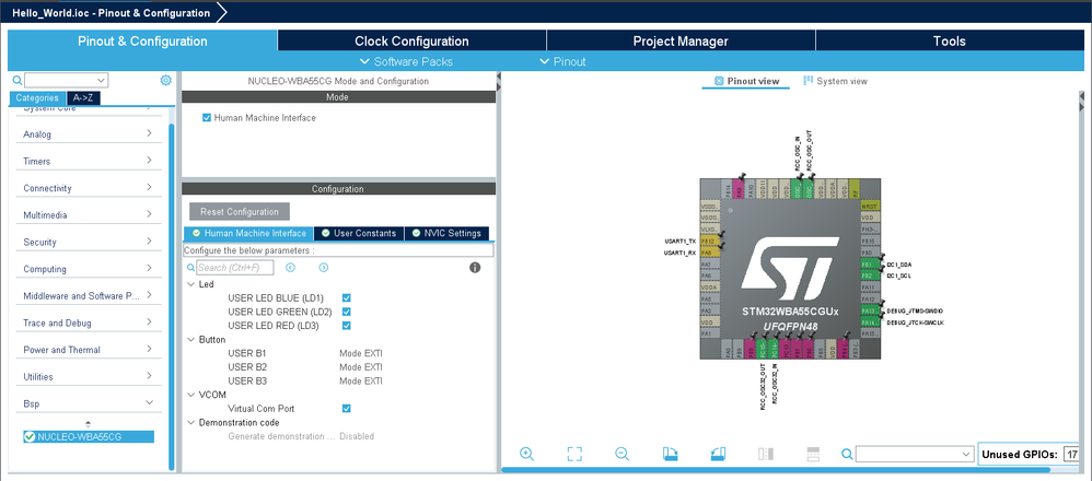

Thank you for the suggestion!
Yes, I can confirm that all the necessary BSP components were enabled for the expansion board.
I also ran another test: I kept I2C1 enabled but disabled the X-CUBE-MEMS1 pack. With that change, all the build errors disappeared. This seems to confirm the issue is specifically with the MEMS software pack.

You'd have thought that should be covered by this setting:
Thank you for your response. And I also had the same expectation that the code generator would define everything automatically.
As my screenshot shows in above reply, the problem starts the moment I enable the X-CUBE-MEMS1 pack. The BSP IT priority definitions are removed and USE_BSP_COM_FEATURE changed to 0U
You should be able to find a place within a USER CODE section to prevent that ?
(Of course, this doesn't alter the fact that you shouldn't need to do it at all)
I have tried placed those definition code in USER CODE Header block in stm32wbaxx_nucleo_conf.h. The code disappeared once I run "Device Configuration Tool Code Generation".
