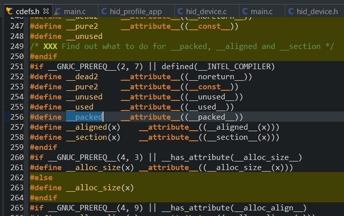

  • inside arm-gcc toolchain - cdefs.h

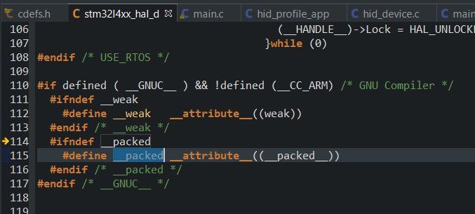

  • HAL libs ensure that macro exists - stm32l4xx_hal_defs.h

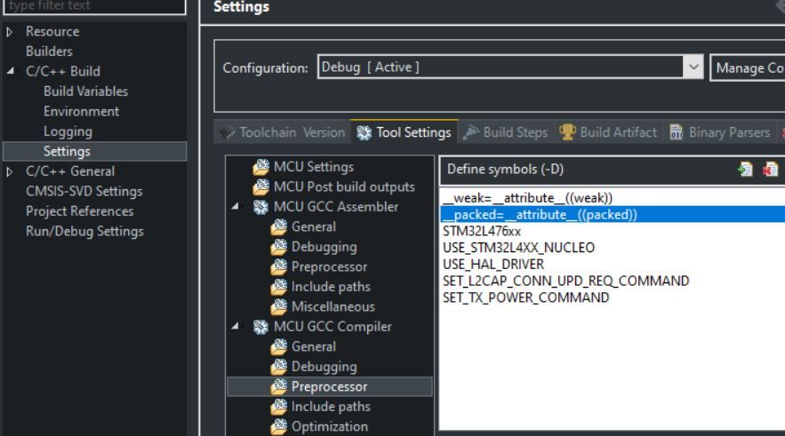

  • CubeMX adds such a define as compiler cmd args - GCC Compiler Settings -> Preprocessor

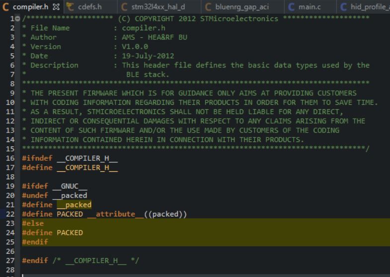

Compiler compatibility is intended to be done in a file from X-CUBE-BLE1 stack called compiler.h (X-CUBE-BLE1\4.4.0\Middlewares\ST\BlueNRG-MS\includes). This is how it looks:
So what REALLY happens: if we have GCC then __GNUC__ macro is defined, then __packed gets undef'ed, redefined to be empty and PACKED macro is used instead. While if we don't have the GCC both __packed would be absent on a project level as well as PACKED gets defined as empty.
As a result, my structs declared with __packed are NOT PACKED in fact, because __packed gets redefined to be empty instead of __attribute__((packed)).
This is absolutely ridiculous and I've killed couple of days figuring out the issue was that structs were not packed when I expected them being so.
I would assume the initial intention was compiler.h line 19 to be #ifndef __GNUC__ like this:
#ifndef __GNUC__
#undef __packed
#define __packed
#define PACKED __attribute__((packed))
#else
#define PACKED
#endif
then the code would use __packed in case of GCC and PACKED in case of other compilers. However this exact code is also copied to file "bluenrg_types.h" of the same "includes" folder. Looks like a copy-paste error to me.
