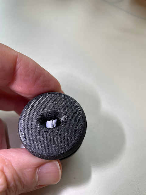

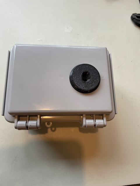

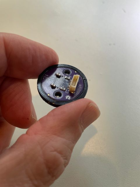

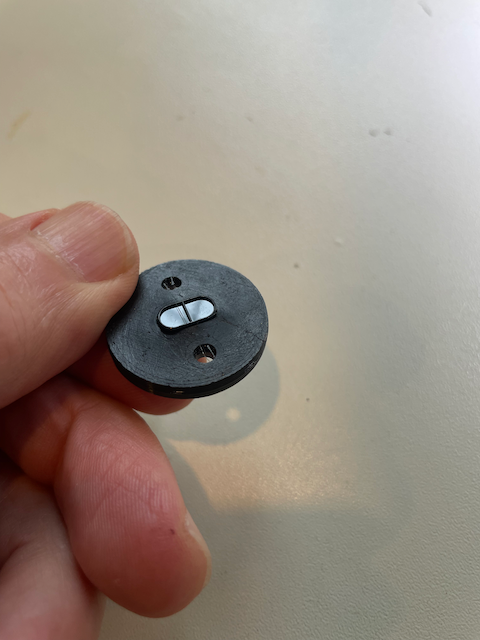

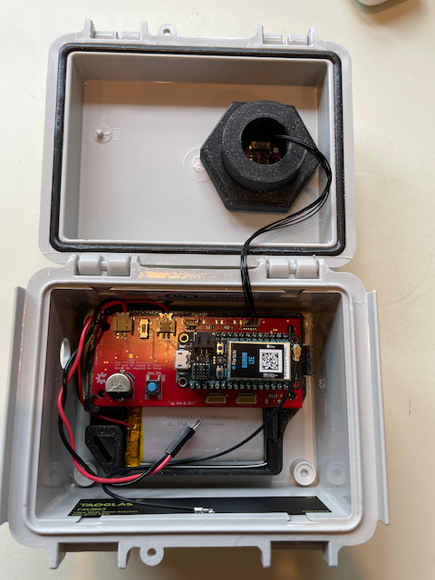

chipmc
Thank you John. I am going to test this implementation that includes a lens cover from Hornix and a bit of an indent that should provide some shade. The application here is people counting in outdoor environments (likely to be shaded as they are in the woods).
