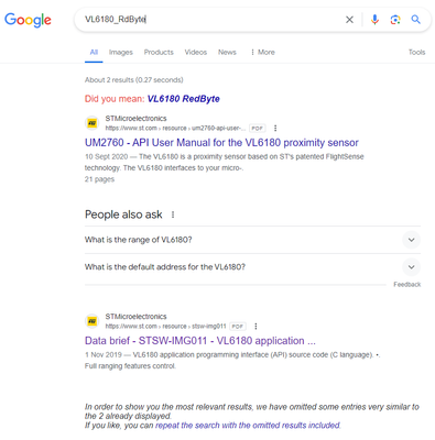

EDIT:
Looks like these are the docs you need:
This is also what I understand the definition seems to be missing, however it is present in
